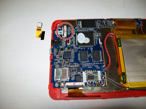

    • Use the plastic opening tools to pry open the back case of the device.
  2. Hipstreet Titan Plus Camera Replacement: crwdns2935265:02crwdnd2935265:01crwdnd2935265:01crwdne2935265:0
    crwdns2942207:0crwdne2942207:0

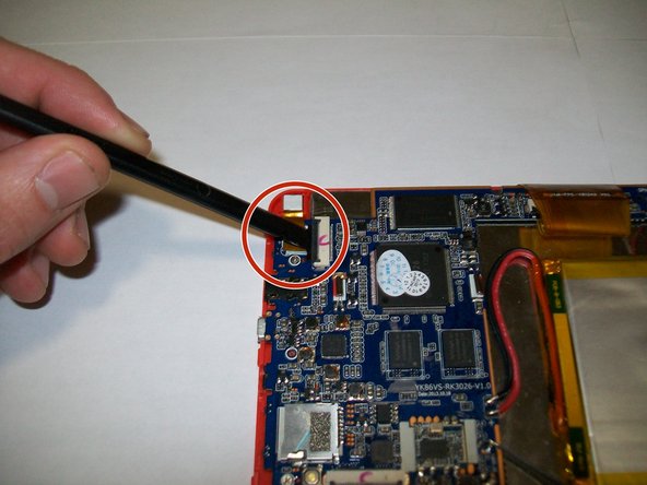

    • Use tweezers to remove the black adhesive strips from the wires. Set aside
  3. Hipstreet Titan Plus Camera Replacement: crwdns2935265:03crwdnd2935265:01crwdnd2935265:03crwdne2935265:0 Hipstreet Titan Plus Camera Replacement: crwdns2935265:03crwdnd2935265:02crwdnd2935265:03crwdne2935265:0 Hipstreet Titan Plus Camera Replacement: crwdns2935265:03crwdnd2935265:03crwdnd2935265:03crwdne2935265:0
    • Use a spudger to undo the black clip connecting the camera wires to the motherboard.
