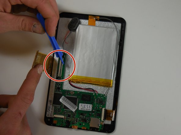

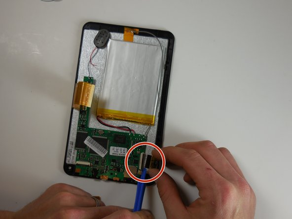

    • Using a #PH000 screwdriver, remove the three 0.145in circuit board placement screws.
  9. Hipstreet Titan 2 HD Speaker Replacement: crwdns2935265:09crwdnd2935265:01crwdnd2935265:03crwdne2935265:0 Hipstreet Titan 2 HD Speaker Replacement: crwdns2935265:09crwdnd2935265:02crwdnd2935265:03crwdne2935265:0 Hipstreet Titan 2 HD Speaker Replacement: crwdns2935265:09crwdnd2935265:03crwdnd2935265:03crwdne2935265:0
    • Lift the hinge locks on the three ribbon connectors and disconnect the ribbon connectors.
