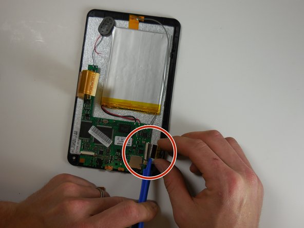

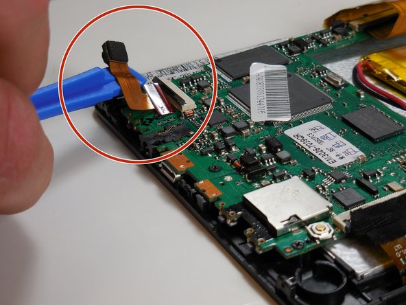

    • Lift the hinges on the three ribbon connector clips and disconnect the ribbon connector.

    • Using the PH#00 screwdriver, remove the three 0.145 inch circuit board screws.
  9. Hipstreet Titan 2 HD Screen Replacement: crwdns2935265:09crwdnd2935265:01crwdnd2935265:01crwdne2935265:0
    • Remove battery, speaker and circuit board from screen.
    • Gently move circuit board assembly with speaker and battery away from device to ensure you do not damage the solder connections.

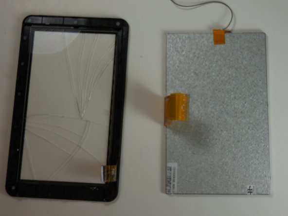

    • Use plastic opening tools to remove screen from front cover.
    • The screen is held in with plastic tabs.
    • Use of too much force on the screen may result in unwanted damage to screen.
    • To avoid damage to screen, ensure the metal screen cover does not catch on the plastic tabs.
  11. Hipstreet Titan 2 HD Screen Replacement: crwdns2935265:011crwdnd2935265:01crwdnd2935265:01crwdne2935265:0
    • Remove screen solder connector with solder removal tool.
    • Solder new screen wire to circuit board with soldering tool.

Your step 11 is irrelevant since this look like it is the wifi antenna.
The other end of this wire is not connected to the screen. I suggested removing gently the other end from the casing (it's held with adhesive) and so, no soldering at all to do.
Otherwise, great guide! Thanks!
