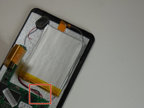

  7. Hipstreet Titan 2 HD Battery Replacement, Battery: crwdns2935265:07crwdnd2935265:01crwdnd2935265:02crwdne2935265:0 Hipstreet Titan 2 HD Battery Replacement, Battery: crwdns2935265:07crwdnd2935265:02crwdnd2935265:02crwdne2935265:0
    • Remove the black placement tape from the battery.
    • Find the two battery solder connections on the circuit board.
  8. Hipstreet Titan 2 HD Battery Replacement: crwdns2935265:08crwdnd2935265:01crwdnd2935265:01crwdne2935265:0
    • Remove the red and black battery wires from the circuit board with the solder removal tool.
  9. Hipstreet Titan 2 HD Battery Replacement: crwdns2935265:09crwdnd2935265:01crwdnd2935265:01crwdne2935265:0
    • Solder the new battery wire connectors to the circuit board.
    • The battery wires must be installed with the red wire on the left and black wire on the right.
