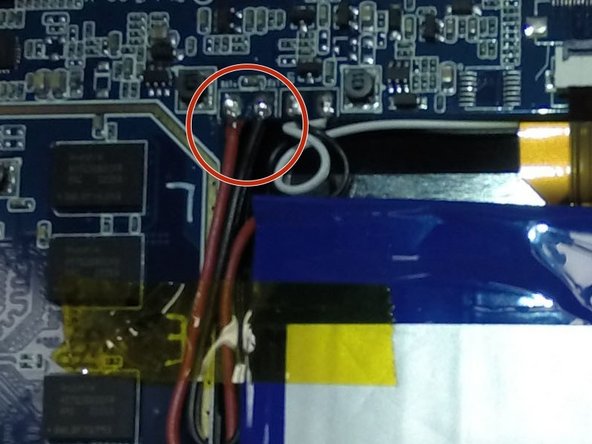

  6. Hipstreet Equinox 2 Screen Replacement, Motherboard: crwdns2935265:06crwdnd2935265:01crwdnd2935265:01crwdne2935265:0
    • Unsolder these wires from the motherboard, it is a good idea to label these wires as you remove them according to the picture to the left.
