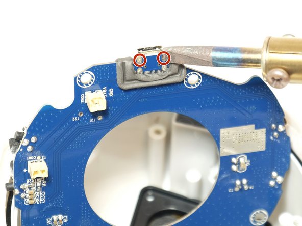

  5. Heyday Wireless Speaker 8125 Charging Port Replacement, Charging Port: crwdns2935265:05crwdnd2935265:01crwdnd2935265:02crwdne2935265:0 Heyday Wireless Speaker 8125 Charging Port Replacement, Charging Port: crwdns2935265:05crwdnd2935265:02crwdnd2935265:02crwdne2935265:0
    • Flip the board upside down.
    • Use a soldering iron to desolder the charging ports' solder joints.
    • Please refer to the How To Solder And Desolder Connections guide link for more information on soldering.
    • Use caution when soldering. Not only can the soldering tool harm you, but if used incorrectly, it could damage the device's motherboard as well.
    • Remove the charging port.
