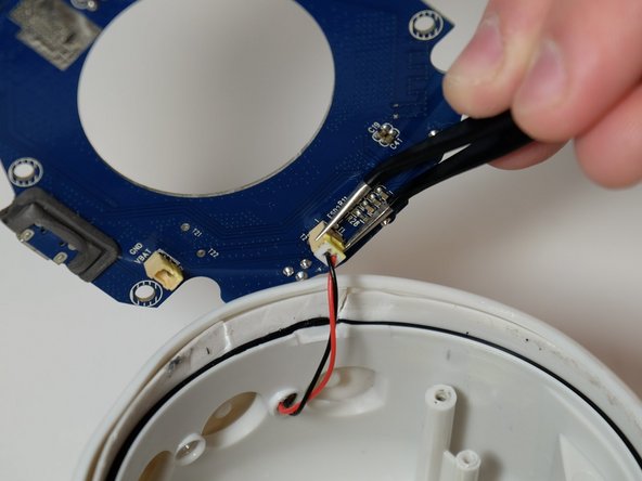

  3. Heyday Wireless Speaker 8125 Button Replacement, Motherboard: crwdns2935265:03crwdnd2935265:01crwdnd2935265:03crwdne2935265:0 Heyday Wireless Speaker 8125 Button Replacement, Motherboard: crwdns2935265:03crwdnd2935265:02crwdnd2935265:03crwdne2935265:0 Heyday Wireless Speaker 8125 Button Replacement, Motherboard: crwdns2935265:03crwdnd2935265:03crwdnd2935265:03crwdne2935265:0
    • Use a Phillips screwdriver to remove four 6.6 mm screws from the motherboard.
    • Lift the motherboard out of the speaker gently.
    • It's attached below by a couple of cables, so don't pull it out.
  4. Heyday Wireless Speaker 8125 Button Replacement: crwdns2935265:04crwdnd2935265:01crwdnd2935265:02crwdne2935265:0 Heyday Wireless Speaker 8125 Button Replacement: crwdns2935265:04crwdnd2935265:02crwdnd2935265:02crwdne2935265:0
    • Pull each cable away from the connector in the same direction that the individual wires are running.
    • Pull evenly on the full width of the cable so that no individual wires are overly strained.
    • Remove the motherboard from the device.
