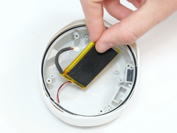

  5. Heyday Wireless Speaker 8125 Battery Replacement, Battery: crwdns2935265:05crwdnd2935265:01crwdnd2935265:02crwdne2935265:0 Heyday Wireless Speaker 8125 Battery Replacement, Battery: crwdns2935265:05crwdnd2935265:02crwdnd2935265:02crwdne2935265:0
    • Use a Phillips screwdriver to remove three 6.6 mm screws from the triangular plastic support.
    • Lift the plastic support to reveal the battery underneath.
  6. Heyday Wireless Speaker 8125 Battery Replacement: crwdns2935265:06crwdnd2935265:01crwdnd2935265:02crwdne2935265:0 Heyday Wireless Speaker 8125 Battery Replacement: crwdns2935265:06crwdnd2935265:02crwdnd2935265:02crwdne2935265:0
    • Use an opening tool or plastic spudger to gently pry the battery from the bottom of the device.
    • The battery is held down with adhesive so it will take a bit of work to remove.
    • Don't bend or puncture the battery in the process. Batteries can cause a fire or worse if damaged.
    • Remove the battery.
