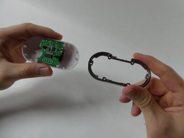

  3. Heyday True Wireless Earbuds 8204 Hinge Bracket Replacement, Hinge Bracket: crwdns2935265:03crwdnd2935265:01crwdnd2935265:02crwdne2935265:0 Heyday True Wireless Earbuds 8204 Hinge Bracket Replacement, Hinge Bracket: crwdns2935265:03crwdnd2935265:02crwdnd2935265:02crwdne2935265:0
    • Use your H1.5 screw bit and gently remove the six screws on the silver retaining ring that holds in the motherboard.
    • After the screws are removed from the case, put the screws aside and remove the ring from the base.
