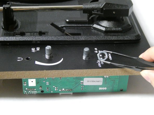

  4. Heyday Suitcase Turntable Volume Knob Replacement, Volume Knob: crwdns2935265:04crwdnd2935265:01crwdnd2935265:01crwdne2935265:0
    • Use a metal spudger to pry the volume knob off of the baseboard.
  5. Heyday Suitcase Turntable Volume Knob Replacement: crwdns2935265:05crwdnd2935265:01crwdnd2935265:02crwdne2935265:0 Heyday Suitcase Turntable Volume Knob Replacement: crwdns2935265:05crwdnd2935265:02crwdnd2935265:02crwdne2935265:0
    • Use your fingers to unscrew the nut securing the volume knob.
  6. Heyday Suitcase Turntable Volume Knob Replacement: crwdns2935265:06crwdnd2935265:01crwdnd2935265:01crwdne2935265:0
    • Use a metal spudger to pry the power knob off of the baseboard.
  7. Heyday Suitcase Turntable Volume Knob Replacement: crwdns2935265:07crwdnd2935265:01crwdnd2935265:02crwdne2935265:0 Heyday Suitcase Turntable Volume Knob Replacement: crwdns2935265:07crwdnd2935265:02crwdnd2935265:02crwdne2935265:0
    • Use your fingers to unscrew the nut securing the power knob.
  8. Heyday Suitcase Turntable Volume Knob Replacement: crwdns2935265:08crwdnd2935265:01crwdnd2935265:01crwdne2935265:0
    • Pull the circuit board down from the baseboard to separate them.
  9. Heyday Suitcase Turntable Volume Knob Replacement: crwdns2935265:09crwdnd2935265:01crwdnd2935265:01crwdne2935265:0
    • To release the volume knob, desolder each of the eight solder joints.
