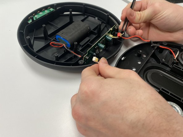

  5. Heyday Round Bluetooth Speaker Subwoofer Replacement, Subwoofer: crwdns2935265:05crwdnd2935265:01crwdnd2935265:02crwdne2935265:0 Heyday Round Bluetooth Speaker Subwoofer Replacement, Subwoofer: crwdns2935265:05crwdnd2935265:02crwdnd2935265:02crwdne2935265:0
    • Use curved tip tweezers to detach the connectors of two 2-prong Aux In/Out plugs extending from the subwoofer.

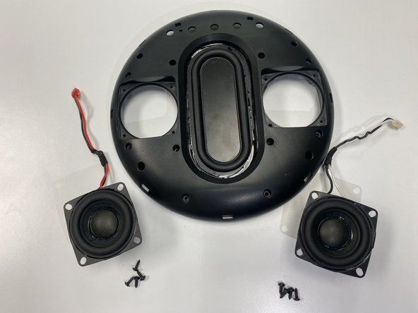

  6. Heyday Round Bluetooth Speaker Subwoofer Replacement: crwdns2935265:06crwdnd2935265:01crwdnd2935265:02crwdne2935265:0 Heyday Round Bluetooth Speaker Subwoofer Replacement: crwdns2935265:06crwdnd2935265:02crwdnd2935265:02crwdne2935265:0
    • Use a Phillips #0 screwdriver to remove the four screws at the edge of each subwoofer to release them.
    • Remove both subwoofers.
