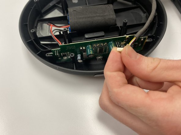

  6. Heyday Round Bluetooth Speaker Motherboard Replacement: crwdns2935265:06crwdnd2935265:01crwdnd2935265:02crwdne2935265:0 Heyday Round Bluetooth Speaker Motherboard Replacement: crwdns2935265:06crwdnd2935265:02crwdnd2935265:02crwdne2935265:0
    • Use a pair of tweezers to disconnect the yellow wire from the motherboard by pinching the input and pulling away from the motherboard.
  7. Heyday Round Bluetooth Speaker Motherboard Replacement: crwdns2935265:07crwdnd2935265:01crwdnd2935265:01crwdne2935265:0
    • Carefully remove the motherboard by sliding it upwards.
