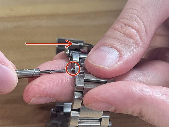

  1. Helm Khuraburi Watch Adjustment and Sizing Guide, Removal of Bracelet: crwdns2935265:01crwdnd2935265:01crwdnd2935265:02crwdne2935265:0 Helm Khuraburi Watch Adjustment and Sizing Guide, Removal of Bracelet: crwdns2935265:01crwdnd2935265:02crwdnd2935265:02crwdne2935265:0

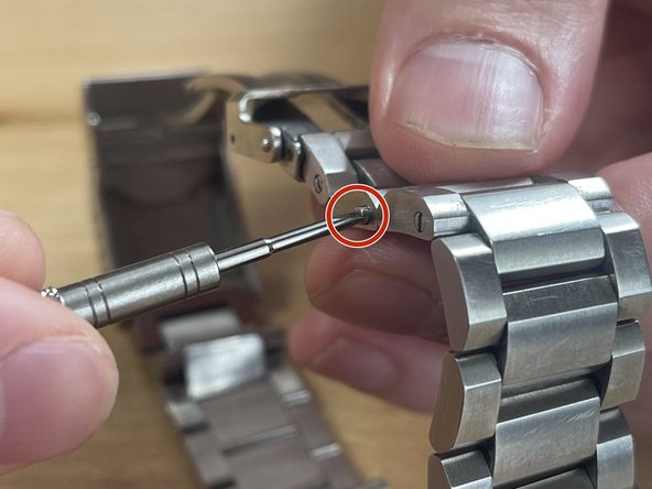

    • Use a small screwdriver to remove the screws on one side of the bracelet (there are several screws, choose the most accessible). This will open the watch bracelet.

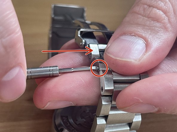

  2. Helm Khuraburi Watch Adjustment and Sizing Guide, Removing the Spring Bar from the Watch Case: crwdns2935265:02crwdnd2935265:01crwdnd2935265:02crwdne2935265:0 Helm Khuraburi Watch Adjustment and Sizing Guide, Removing the Spring Bar from the Watch Case: crwdns2935265:02crwdnd2935265:02crwdnd2935265:02crwdne2935265:0
    • While applying constant tension in an outward direction, with a spring bar tool, carefully release the spring bar from its retaining hole in the watch case.

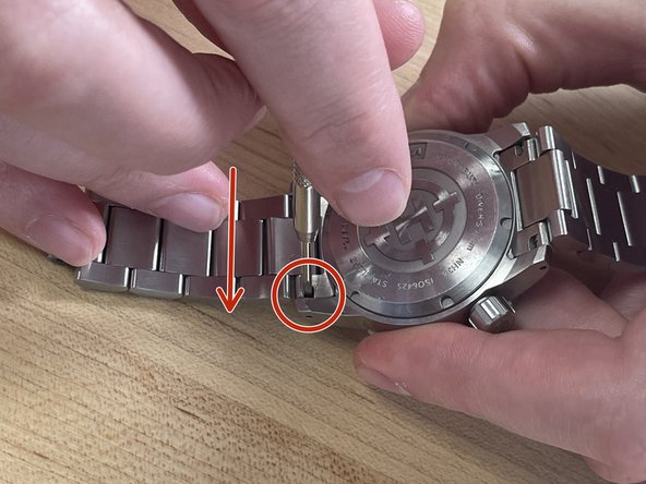

  3. Helm Khuraburi Watch Adjustment and Sizing Guide, Detaching the Bracelet from the Watch Case: crwdns2935265:03crwdnd2935265:01crwdnd2935265:01crwdne2935265:0
    • Continuing to apply constant tension, remove the spring bar from its retaining hole in the watch case on the other side. This will release the bracelet from the case, allowing us to access the links we need to add or remove more easily.

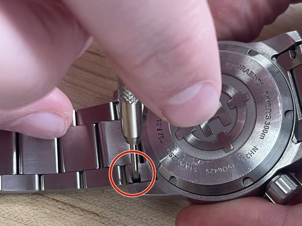

  4. Helm Khuraburi Watch Adjustment and Sizing Guide, Adjusting the Bracelet by Removing Links: crwdns2935265:04crwdnd2935265:01crwdnd2935265:02crwdne2935265:0 Helm Khuraburi Watch Adjustment and Sizing Guide, Adjusting the Bracelet by Removing Links: crwdns2935265:04crwdnd2935265:02crwdnd2935265:02crwdne2935265:0

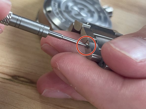

    • With the bracelet removed from the case, unscrew any link that you wish to remove.

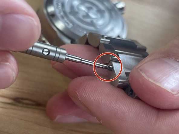

    • Reattach the links by inserting screws into the holes, ensuring each screw is tight and the links are secure.

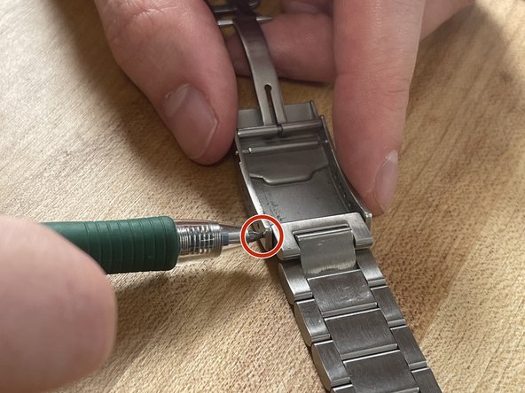

  10. Helm Khuraburi Watch Adjustment and Sizing Guide, Fine-Tuning the Clasp Position: crwdns2935265:011crwdnd2935265:01crwdnd2935265:03crwdne2935265:0 Helm Khuraburi Watch Adjustment and Sizing Guide, Fine-Tuning the Clasp Position: crwdns2935265:011crwdnd2935265:02crwdnd2935265:03crwdne2935265:0 Helm Khuraburi Watch Adjustment and Sizing Guide, Fine-Tuning the Clasp Position: crwdns2935265:011crwdnd2935265:03crwdnd2935265:03crwdne2935265:0
    • If further smaller adjustments are needed, adjust the clasp mechanism. Use a pen to depress the spring bar holding the clasp in place while applying pressure towards the desired direction.

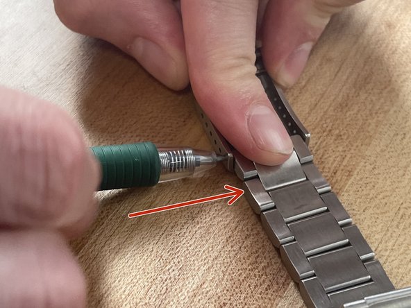

  11. Helm Khuraburi Watch Adjustment and Sizing Guide, nserting the Clasp into the Springbar Mechanism: crwdns2935265:012crwdnd2935265:01crwdnd2935265:01crwdne2935265:0
    • Depress the other side of the spring bar so that the clasp slides into and is even within the mechanism.
