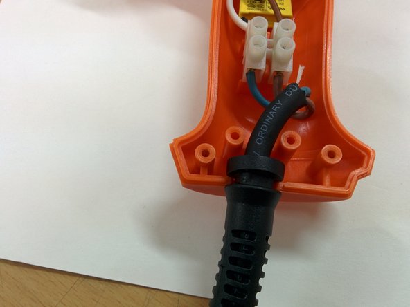

      • All screws on one side for ease of assembly
      • Wire has a stiffener for protection
      • Switch is placed on handle in an ergonomic position so that one hand operation is easy
      • The back of the handle and the back of the body are in a straight plane in order to place the gun in vertical position after operation to cool it down
      • Vents are placed in the top part to facilitate air flow
      • The product is colored in industrial orange to be easily visible and distinguishable from the work environment

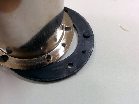

    2. Heat Gun Disassembly, Plastic detailing: crwdns2935265:02crwdnd2935265:01crwdnd2935265:03crwdne2935265:0 Heat Gun Disassembly, Plastic detailing: crwdns2935265:02crwdnd2935265:02crwdnd2935265:03crwdne2935265:0 Heat Gun Disassembly, Plastic detailing: crwdns2935265:02crwdnd2935265:03crwdnd2935265:03crwdne2935265:0
      • All plastic detailing is made to have no overhangs
      • screwing details are used in order to locate the two half together without external jig
      • A lip joint is used in order to secure the assembly and also make it impermeable and rigid
    3. Heat Gun Disassembly, Electrical component placement: crwdns2935265:03crwdnd2935265:01crwdnd2935265:02crwdne2935265:0 Heat Gun Disassembly, Electrical component placement: crwdns2935265:03crwdnd2935265:02crwdnd2935265:02crwdne2935265:0
      • All electrical components are connected using connectors instead of direct soldering to facilitate easy replacement
      • The components have negative placers inbuilt in the in plastic injection mold
      • The electrical components are placed in order to prevent shorting

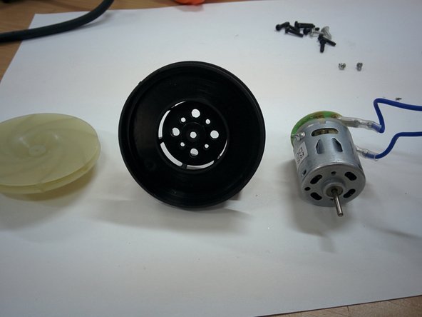

    4. Heat Gun Disassembly, Heat component placements: crwdns2935265:04crwdnd2935265:01crwdnd2935265:03crwdne2935265:0 Heat Gun Disassembly, Heat component placements: crwdns2935265:04crwdnd2935265:02crwdnd2935265:03crwdne2935265:0 Heat Gun Disassembly, Heat component placements: crwdns2935265:04crwdnd2935265:03crwdnd2935265:03crwdne2935265:0
      • All heat components are suspended in order to prevent the heated elements to come in contact with plastic parts
      • The blower chamber is designed in heat resistant pet in order to prevent it from deformation
      • The motor and the blower fan has a press fit

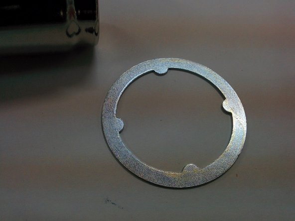

    5. Heat Gun Disassembly, Heat tube: crwdns2935265:05crwdnd2935265:01crwdnd2935265:02crwdne2935265:0 Heat Gun Disassembly, Heat tube: crwdns2935265:05crwdnd2935265:02crwdnd2935265:02crwdne2935265:0
      • The heat tube is using mica support and kapton insulation
      • The external heat tube is stainless steel to prevent degradation of the tube.
      • The heat coil is used as a resistor to step down voltage for motor and hence it has a dual perpose
      • The heat coil is made of nichrome wire.
    6. Heat Gun Disassembly, Detail assembly: crwdns2935265:06crwdnd2935265:01crwdnd2935265:03crwdne2935265:0 Heat Gun Disassembly, Detail assembly: crwdns2935265:06crwdnd2935265:02crwdnd2935265:03crwdne2935265:0 Heat Gun Disassembly, Detail assembly: crwdns2935265:06crwdnd2935265:03crwdnd2935265:03crwdne2935265:0
      • Minimum number of screws (variety) are used and all screws are self tapping in order to eliminate the use of nuts and loose parts.
      • Assembly has location pins to align circular parts in a fixed orientation.
      • Heat rings are used in order to over heating

Any idea where I can get a replacement for the plastic fan? It just fell off and melted and there doesn’t seem to be any information on the net. It’s a simple part. I’ve only used the gun a half a dozen times but it’s been years since it was purchased. Your instructions were helpful.
