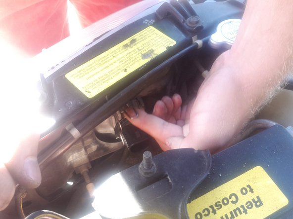

    • Before you begin, make sure you have the right bulb. I got this at the local autozone.
    • Do NOT touch the glass of the bulb. The oils from your fingers can drastically reduce the life of the bulb.
    • Vinyl or latex gloves are great if you have them available, but not required.
  2. Headlight Bulb Replacement: crwdns2935265:02crwdnd2935265:01crwdnd2935265:02crwdne2935265:0 Headlight Bulb Replacement: crwdns2935265:02crwdnd2935265:02crwdnd2935265:02crwdne2935265:0
    • Press firmly on the plugs clip and pull to remove the power cable from the bulb.

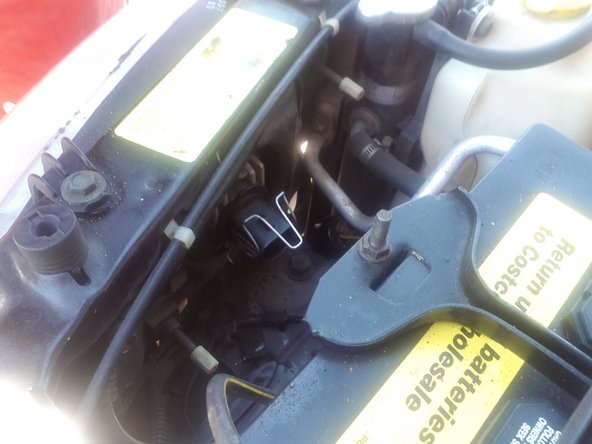

  3. Headlight Bulb Replacement: crwdns2935265:03crwdnd2935265:01crwdnd2935265:03crwdne2935265:0 Headlight Bulb Replacement: crwdns2935265:03crwdnd2935265:02crwdnd2935265:03crwdne2935265:0 Headlight Bulb Replacement: crwdns2935265:03crwdnd2935265:03crwdnd2935265:03crwdne2935265:0
    • Lift up and remove the metal wire cage holding the bulb in place.
  4. Headlight Bulb Replacement: crwdns2935265:04crwdnd2935265:01crwdnd2935265:01crwdne2935265:0
    • Remove the bulb by pulling it away from the headlight enclosure.
    • Once the old bulb is removed, take your new one and place it in the headlight.
    • Follow the steps in reverse to secure the new bulb in the headlight.
To replace the bulb, follow the steps in reverse order.
