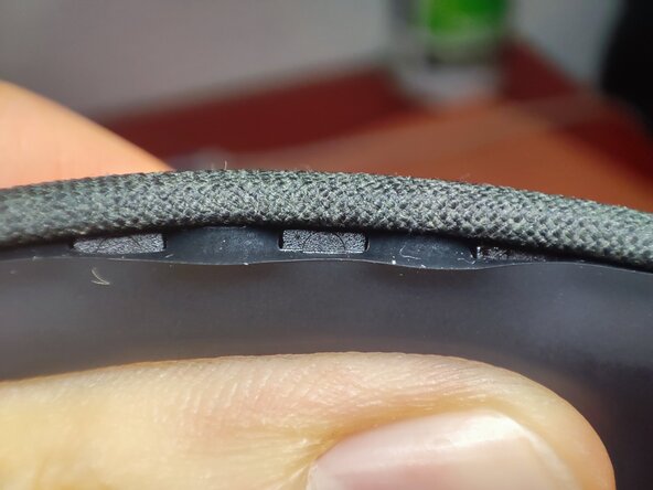

    • Slide the silicone overlay down with your finger to expose the 'teeth'.
    • Then, using a pry tool or a thin screwdriver, gently pry between the teeth slightly sideways and then downwards to release the plastic latch from the tooth.
    • Start in the middle and work your way towards the edges.
    • Make sure you are pulling on the plastic frame inside with the screwdriver, not the silicone case. Refer to the last picture to understand how it is assembled (red lines indicate the tooth).

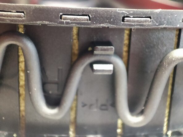

  2. Headband repair, Release the cable: crwdns2935265:02crwdnd2935265:01crwdnd2935265:02crwdne2935265:0 Headband repair, Release the cable: crwdns2935265:02crwdnd2935265:02crwdnd2935265:02crwdne2935265:0
    • Release the cable from the clamp

I dont get how the silicon is attached can you explain that to me better
Maurits -
The best way I’ve found is to use two screwdrivers: one very small and one larger flathead. First, insert both into the small hole in the silicone and stretch it so it thins out — it’s quite strong, but be careful. Then, with the larger screwdriver, twist gently to widen the gap between the head bend and the teeth; otherwise, you won’t be able to fit it. Finally, push it over the teeth — with a bit of fiddling, it will slip into place.
