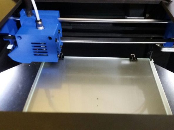

  1. Head Cleaning V4/V5, Setting the printer: crwdns2935265:01crwdnd2935265:01crwdnd2935265:02crwdne2935265:0 Head Cleaning V4/V5, Setting the printer: crwdns2935265:01crwdnd2935265:02crwdnd2935265:02crwdne2935265:0
    • With the printer powered on, enter the menu screen and select the "Config. Rápida" (Quick Setup) option.
    • In the quick settings, select the "Retreat Table" option.
  2. Head Cleaning V4/V5, Repositioning the table: crwdns2935265:02crwdnd2935265:01crwdnd2935265:03crwdne2935265:0 Head Cleaning V4/V5, Repositioning the table: crwdns2935265:02crwdnd2935265:02crwdnd2935265:03crwdne2935265:0 Head Cleaning V4/V5, Repositioning the table: crwdns2935265:02crwdnd2935265:03crwdnd2935265:03crwdne2935265:0
    • When the table is in the position shown in the photo, press the Reset button on the left side of the machine, as shown.
    • Select the "Pré-aquecer PLA" (Preheat PLA) option from the quick settings menu.

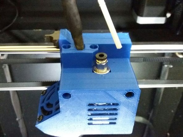

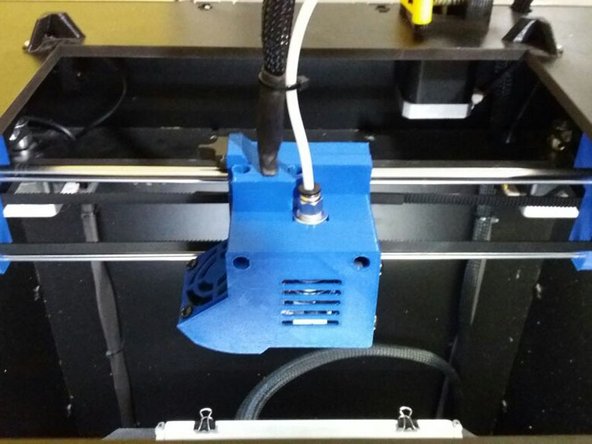

  3. Head Cleaning V4/V5, Repositioning the head: crwdns2935265:03crwdnd2935265:01crwdnd2935265:02crwdne2935265:0 Head Cleaning V4/V5, Repositioning the head: crwdns2935265:03crwdnd2935265:02crwdnd2935265:02crwdne2935265:0
    • With the table in place, manually push the head to the center of the machine for easier handling.

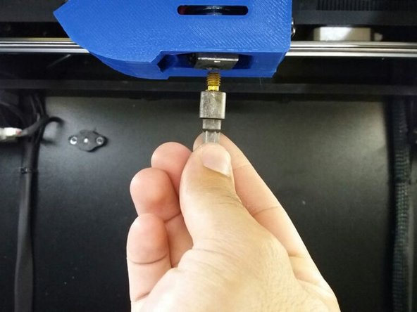

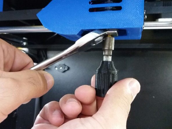

  4. Head Cleaning V4/V5, Removing the nozzle: crwdns2935265:04crwdnd2935265:01crwdnd2935265:03crwdne2935265:0 Head Cleaning V4/V5, Removing the nozzle: crwdns2935265:04crwdnd2935265:02crwdnd2935265:03crwdne2935265:0 Head Cleaning V4/V5, Removing the nozzle: crwdns2935265:04crwdnd2935265:03crwdnd2935265:03crwdne2935265:0
    • Position the 20mm Fork Spanner, as shown in the figure, locking the inside of the head in order to prevent the nozzle from spinning.
    • With the 7mm Fork Wrench, remove the nozzle from the head.

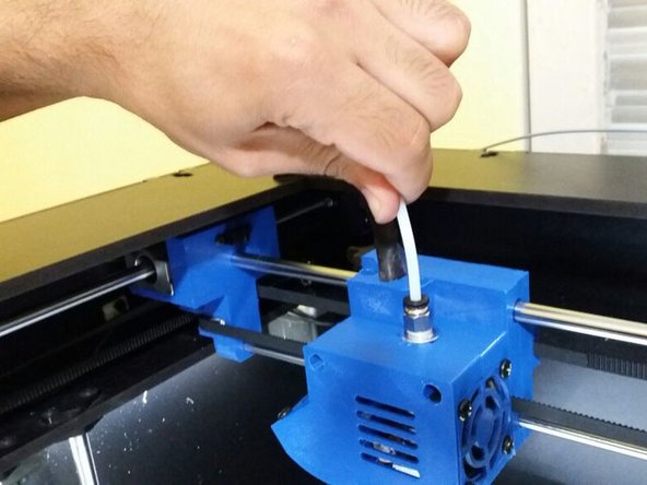

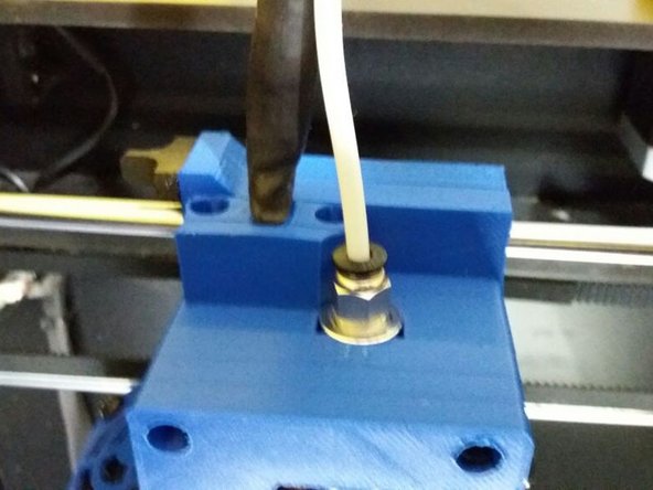

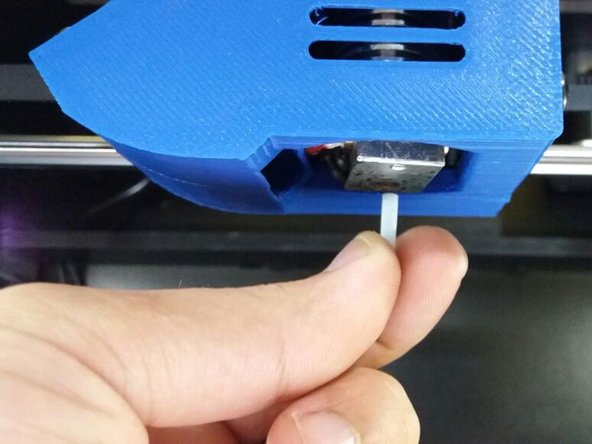

  5. Head Cleaning V4/V5, Removing the top PTFE: crwdns2935265:05crwdnd2935265:01crwdnd2935265:02crwdne2935265:0 Head Cleaning V4/V5, Removing the top PTFE: crwdns2935265:05crwdnd2935265:02crwdnd2935265:02crwdne2935265:0
    • With your hands, pull the PTFE tube from the head, pressing the black part of the piece where the tube is fitted.

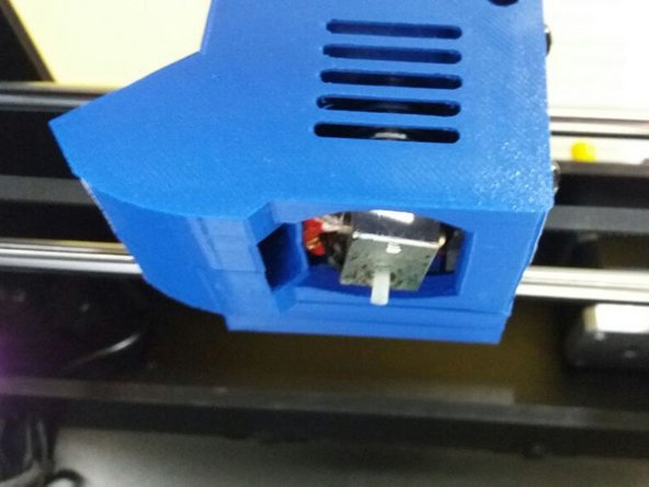

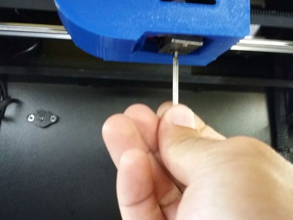

  6. Head Cleaning V4/V5, Removing the inner PTFE: crwdns2935265:06crwdnd2935265:01crwdnd2935265:03crwdne2935265:0 Head Cleaning V4/V5, Removing the inner PTFE: crwdns2935265:06crwdnd2935265:02crwdnd2935265:03crwdne2935265:0 Head Cleaning V4/V5, Removing the inner PTFE: crwdns2935265:06crwdnd2935265:03crwdnd2935265:03crwdne2935265:0
    • Positioning the bit in the indicated hole, push it down until the inner PTFE comes out from under the head (where the nozzle hole is).
  7. Head Cleaning V4/V5, Replacement and Cleaning: crwdns2935265:07crwdnd2935265:01crwdnd2935265:03crwdne2935265:0 Head Cleaning V4/V5, Replacement and Cleaning: crwdns2935265:07crwdnd2935265:02crwdnd2935265:03crwdne2935265:0 Head Cleaning V4/V5, Replacement and Cleaning: crwdns2935265:07crwdnd2935265:03crwdnd2935265:03crwdne2935265:0

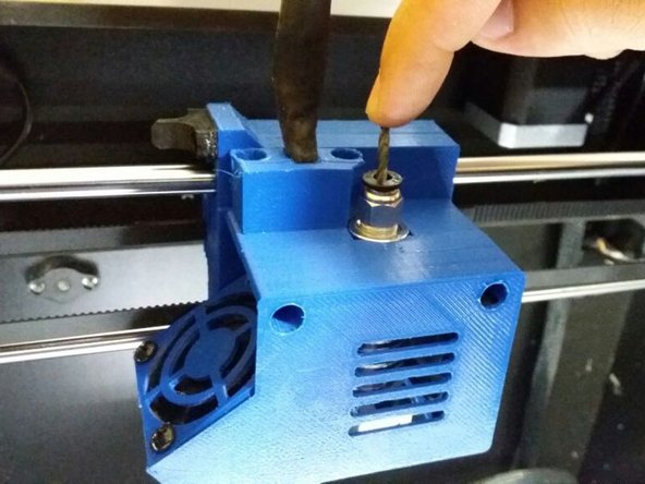

    • Finish removing the internal PTFE and replace it with a new one or clean it.
    • With the drill, clean the nozzle hole as shown in the picture.
    • Put the new inner PTFE in place as shown.
