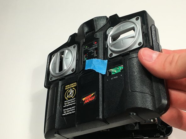

      • Power off the controller before disassembly.
      • Place a small piece of tape over the Light button to prevent it from falling out in later steps.
      • Flip the controller over so the back is facing up.

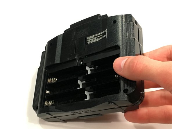

      • Remove the battery compartment screw with a small Phillips screw driver.
      • Lift off the battery cover.
      • Remove the six AA batteries from the compartment.

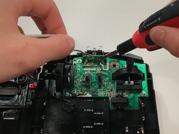

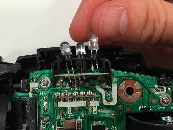

    4. Havoc Heli IR LED  Replacement: crwdns2935265:04crwdnd2935265:01crwdnd2935265:01crwdne2935265:0
      • Lift up the red IR LED cover to remove it.
    5. Havoc Heli IR LED  Replacement: crwdns2935265:05crwdnd2935265:01crwdnd2935265:02crwdne2935265:0 Havoc Heli IR LED  Replacement: crwdns2935265:05crwdnd2935265:02crwdnd2935265:02crwdne2935265:0
      • Use the soldering iron and solder wick to remove the solder from the IR LED you're replacing.
      • Pull the LED out through the top.
    6. Havoc Heli IR LED  Replacement: crwdns2935265:06crwdnd2935265:01crwdnd2935265:02crwdne2935265:0 Havoc Heli IR LED  Replacement: crwdns2935265:06crwdnd2935265:02crwdnd2935265:02crwdne2935265:0
      • Insert the new LED into the slot.
      • Make sure that the short lead of the LED is on the right.
      • Use the soldering iron and solder to connect the new LED.
