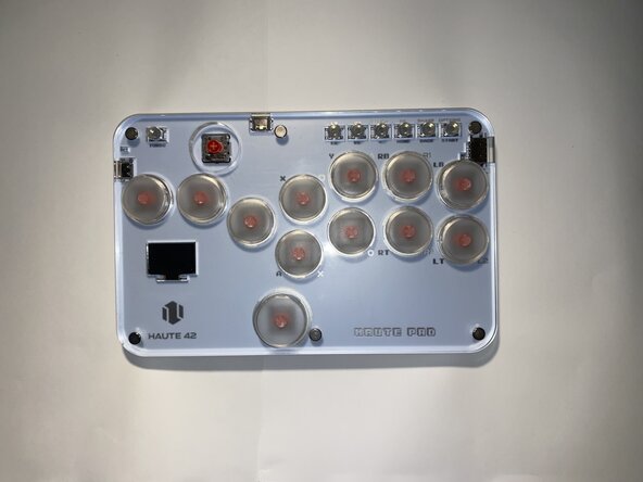

    • Unplug the controller from any device it is connected to and make sure it is powered off.

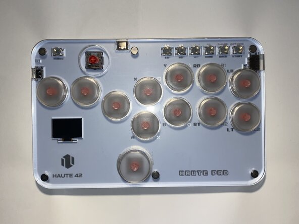

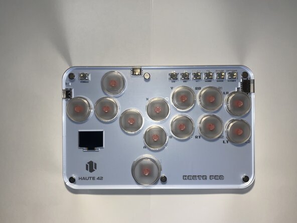

    • Use a keycap puller to remove the keycap from its socket.
    • Avoid using excessive force to prevent damaging the device.

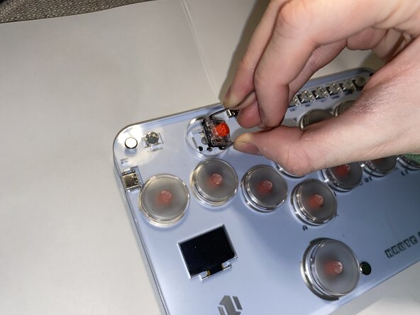

    • Use the keycap/switch puller to remove the switch from its socket.
    • Be careful not to damage the controller while removing the switch.

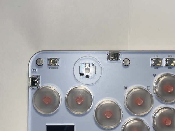

    • Align the pins of the new switch with the holes in the socket and replace the switch.
    • You will feel the pins slide into place.
    • Do not press the switch in until you know you have aligned it correctly, doing so may damage the pins on the switch.

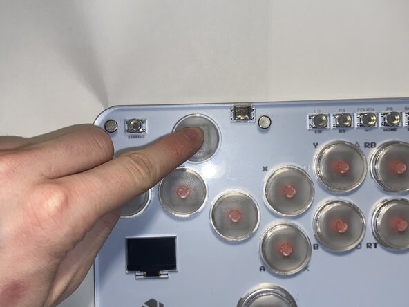

    • Take a look at the OLED input display on the controller while pressing it to check if the button is fully functional.
    • On the screen, the button should highlight itself and the input history should be displayed at the bottom. If it all works, congratulations! You have successfully replaced this button.
