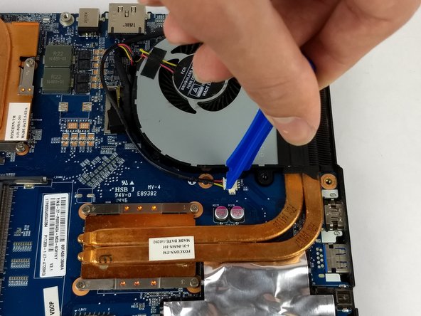

    • To take out the CPU fan it is necessary to disconnect the CPU fan cable. Use a plastic opening tool to remove the cable.

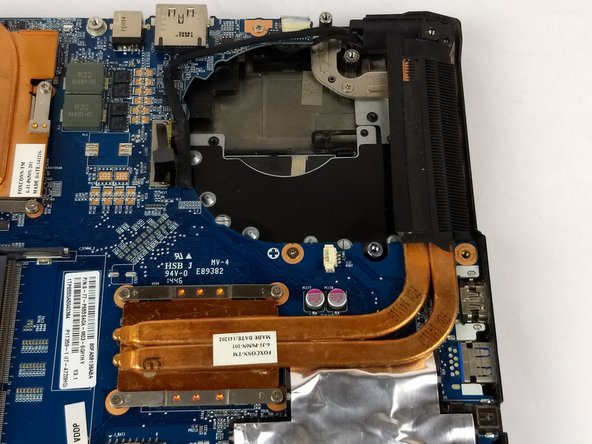

    • Use a #0 Phillips head screwdriver to remove the two 7mm screws holding the fan to the motherboard.
  5. Hasee Z7M-i78172D1 CPU Fan Replacement: crwdns2935265:05crwdnd2935265:01crwdnd2935265:02crwdne2935265:0 Hasee Z7M-i78172D1 CPU Fan Replacement: crwdns2935265:05crwdnd2935265:02crwdnd2935265:02crwdne2935265:0
    • Lift the CPU fan out and replace with the replacement fan.
