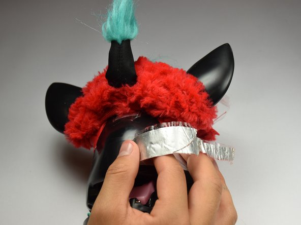

  8. Hasbro furby 2012 Speaker Replacement: crwdns2935265:08crwdnd2935265:01crwdnd2935265:03crwdne2935265:0 Hasbro furby 2012 Speaker Replacement: crwdns2935265:08crwdnd2935265:02crwdnd2935265:03crwdne2935265:0 Hasbro furby 2012 Speaker Replacement: crwdns2935265:08crwdnd2935265:03crwdnd2935265:03crwdne2935265:0
    • Orient the Furby on its side to where the beak is facing left and locate the edge of the aluminum tape.
    • Lift tape gently and peel back until the tape is nearly removed.
    • Do not pull on the yellow wire located on the opposite end of the tape.

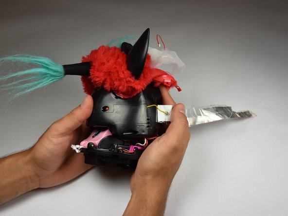

  10. Hasbro furby 2012 Speaker Replacement: crwdns2935265:010crwdnd2935265:01crwdnd2935265:01crwdne2935265:0
    • Peel the tape gently, grabbing it from the bottom edge and folding the tape upward.
    • Peel the tape up until it is nearly detached from the black case.
  11. Hasbro furby 2012 Speaker Replacement: crwdns2935265:011crwdnd2935265:01crwdnd2935265:02crwdne2935265:0 Hasbro furby 2012 Speaker Replacement: crwdns2935265:011crwdnd2935265:02crwdnd2935265:02crwdne2935265:0
    • Orient the Furby face down, with the base facing away from you.
    • Locate the clips below the ears.
    • Repeat the technique used in Step 6. Create leverage using a metal prying tool to press upward into the clip, while also pulling back on the clip itself.
  12. Hasbro furby 2012 Speaker Replacement: crwdns2935265:012crwdnd2935265:01crwdnd2935265:02crwdne2935265:0 Hasbro furby 2012 Speaker Replacement: crwdns2935265:012crwdnd2935265:02crwdnd2935265:02crwdne2935265:0
    • Remove the loose, plastic back panel by pulling the panel away from Furby's body.

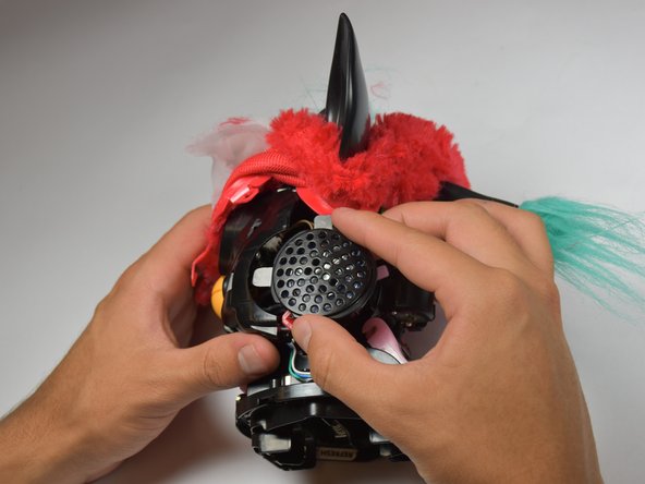

  13. Hasbro furby 2012 Speaker Replacement, Speaker: crwdns2935265:013crwdnd2935265:01crwdnd2935265:02crwdne2935265:0 Hasbro furby 2012 Speaker Replacement, Speaker: crwdns2935265:013crwdnd2935265:02crwdnd2935265:02crwdne2935265:0
    • Orient Furby to where the mouth is facing left. Locate the speaker on the side of the device.
    • Lift the speaker out.
  14. Hasbro furby 2012 Speaker Replacement: crwdns2935265:014crwdnd2935265:01crwdnd2935265:03crwdne2935265:0 Hasbro furby 2012 Speaker Replacement: crwdns2935265:014crwdnd2935265:02crwdnd2935265:03crwdne2935265:0 Hasbro furby 2012 Speaker Replacement: crwdns2935265:014crwdnd2935265:03crwdnd2935265:03crwdne2935265:0
    • Use the blunt tweezers to pinch the latch on the speaker's casing. Detach the speaker from the both latches on both sides and remove the speaker's casing.
  15. Hasbro furby 2012 Speaker Replacement: crwdns2935265:015crwdnd2935265:01crwdnd2935265:02crwdne2935265:0 Hasbro furby 2012 Speaker Replacement: crwdns2935265:015crwdnd2935265:02crwdnd2935265:02crwdne2935265:0
    • Lift the connector, using the Blunt Tweezers, while tugging on the speaker's wire.
    • Plug the new speaker in by clipping the connector into place where the old connector was removed from.
