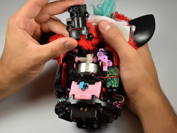

  15. Hasbro furby 2012 DC Motor Replacement, DC Motor: crwdns2935265:015crwdnd2935265:01crwdnd2935265:02crwdne2935265:0 Hasbro furby 2012 DC Motor Replacement, DC Motor: crwdns2935265:015crwdnd2935265:02crwdnd2935265:02crwdne2935265:0
    • Unscrew the four screws holding the motor housing in place.
    • Remove the motor housing.
    • Their is lubricant on and around the DC motor, be careful when handling.

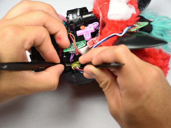

    • Orient Furby with the beak facing right.
    • Locate the red DC motor connector.
    • Gently remove the connector using blunt and pointed tweezers.

How do you connect the new motor after that? and does this work for Furby Booms too?

Hi. Where can I buy a replacement motor please?
rebeccataylor1972 - crwdns2934203:0crwdne2934203:0
Generic replacement motors are on Ebay. The one I got was RF-300CA
I could not find the exact motor.
Specs: 1.5-6 volt.
24.2mm x 12.4mm (24x12).
10 or 12mm long shaft x 2mm diameter.
.99 cents free shipping. Two weeks from China.
https://www.ebay.com/itm/RF-300CA-DC-1-5V-6V-815...
You will need to de-solder the little half-moon shaped control board off the bottom of the old motor. Crazy glue it to the bottom of the new motor. Then solder the the red wires together and black wires together. Then solder them to the board. The old motor had spikes sticking out the bottom to connect the control board. The generic replacement motors have wires instead. I searched the entire internet. I could not find the exact motor.
https://www.youtube.com/watch?v=6WWecJ_I... It’s in Spanish, but you’ll get the idea.
To get the ears off. Firmly twist and pull them…HARD.
Good luck.

And how do I disconnect the coil from the motor? Just pulling hard?
