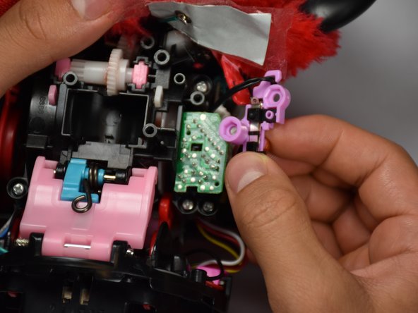

  13. Hasbro Furby 2012 Switch Replacement, Switch: crwdns2935265:013crwdnd2935265:01crwdnd2935265:02crwdne2935265:0 Hasbro Furby 2012 Switch Replacement, Switch: crwdns2935265:013crwdnd2935265:02crwdnd2935265:02crwdne2935265:0
    • Locate and remove the two screws holding in the switch using J0 Phillips Head Screw Driver.

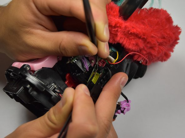

  14. Hasbro Furby 2012 Switch Replacement: crwdns2935265:014crwdnd2935265:01crwdnd2935265:02crwdne2935265:0 Hasbro Furby 2012 Switch Replacement: crwdns2935265:014crwdnd2935265:02crwdnd2935265:02crwdne2935265:0
    • Orient the Furby with the beak facing right.
    • Using the blunt and pointed tweezers, remove the black connector.
    • Insert the new switch in place of where the previous connector was located.
