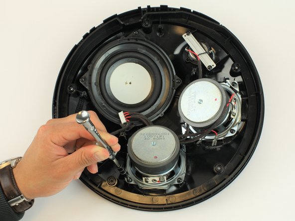

  10. Harman Kardon Onyx Studio 2 Speakers Replacement, Speakers: crwdns2935265:010crwdnd2935265:01crwdnd2935265:01crwdne2935265:0
    • Using the metal spudger, gently pry off the two red and black connectors.
  11. Harman Kardon Onyx Studio 2 Speakers Replacement: crwdns2935265:011crwdnd2935265:01crwdnd2935265:02crwdne2935265:0 Harman Kardon Onyx Studio 2 Speakers Replacement: crwdns2935265:011crwdnd2935265:02crwdnd2935265:02crwdne2935265:0
    • Remove the four 14.3 mm T10 Torx screws.
  12. Harman Kardon Onyx Studio 2 Speakers Replacement: crwdns2935265:012crwdnd2935265:01crwdnd2935265:01crwdne2935265:0
    • Pull out the speaker, and if necessary follow these steps to replace the other identical speaker.
