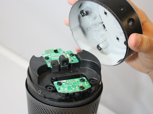

  3. Harman Kardon Invoke Service Port Replacement, Remove the base: crwdns2935265:03crwdnd2935265:01crwdnd2935265:02crwdne2935265:0 Harman Kardon Invoke Service Port Replacement, Remove the base: crwdns2935265:03crwdnd2935265:02crwdnd2935265:02crwdne2935265:0
    • Firmly grip the bottom and wiggle upwards to remove the base.

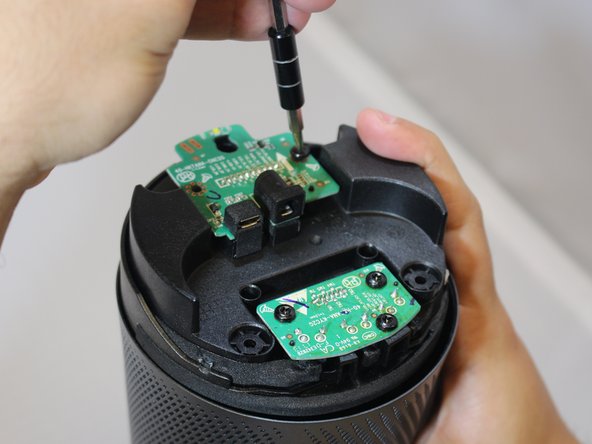

  4. Harman Kardon Invoke Service Port Replacement, Removing the board: crwdns2935265:04crwdnd2935265:01crwdnd2935265:03crwdne2935265:0 Harman Kardon Invoke Service Port Replacement, Removing the board: crwdns2935265:04crwdnd2935265:02crwdnd2935265:03crwdne2935265:0 Harman Kardon Invoke Service Port Replacement, Removing the board: crwdns2935265:04crwdnd2935265:03crwdnd2935265:03crwdne2935265:0
    • Use a #10 Torx screwdriver to remove two 10 mm screws from board attached to ports.
    • Pull board up lightly.
  5. Harman Kardon Invoke Service Port Replacement, Disconnect the board: crwdns2935265:05crwdnd2935265:01crwdnd2935265:02crwdne2935265:0 Harman Kardon Invoke Service Port Replacement, Disconnect the board: crwdns2935265:05crwdnd2935265:02crwdnd2935265:02crwdne2935265:0
    • Pull cable to disconnect board from device.
    • For replacement of service port, you will have to replace whole board that the port is attached to.
