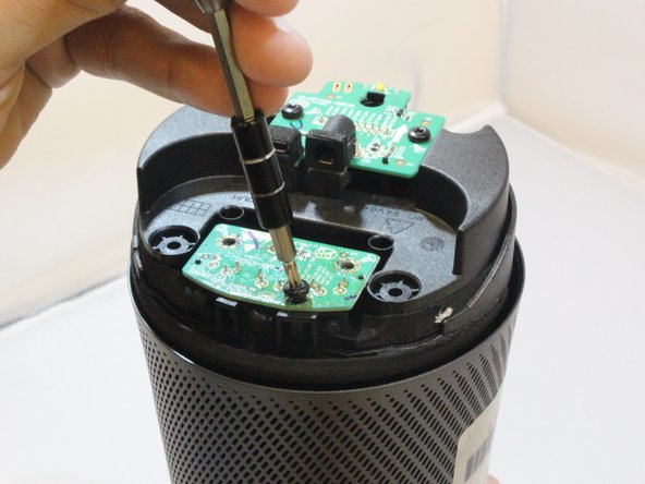

  4. Harman Kardon Invoke Microphone on/off Button Replacement, Unscrew the board: crwdns2935265:04crwdnd2935265:01crwdnd2935265:02crwdne2935265:0 Harman Kardon Invoke Microphone on/off Button Replacement, Unscrew the board: crwdns2935265:04crwdnd2935265:02crwdnd2935265:02crwdne2935265:0
    • Use a Torx #10 screwdriver to remove three 10.0 mm screws from the highlighted board attached to microphone button.
  5. Harman Kardon Invoke Microphone on/off Button Replacement, Remove the board: crwdns2935265:05crwdnd2935265:01crwdnd2935265:02crwdne2935265:0 Harman Kardon Invoke Microphone on/off Button Replacement, Remove the board: crwdns2935265:05crwdnd2935265:02crwdnd2935265:02crwdne2935265:0
    • Pull the cable lightly to disconnect the button board from device.
    • To replace the microphone button, you will have to replace the entire smaller board.
