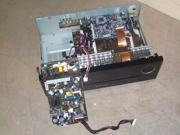

  3. Harman Kardon HK3700 Teardown, Remove the cables and PSU: crwdns2935265:03crwdnd2935265:01crwdnd2935265:03crwdne2935265:0 Harman Kardon HK3700 Teardown, Remove the cables and PSU: crwdns2935265:03crwdnd2935265:02crwdnd2935265:03crwdne2935265:0 Harman Kardon HK3700 Teardown, Remove the cables and PSU: crwdns2935265:03crwdnd2935265:03crwdnd2935265:03crwdne2935265:0
    • Just start by removing any cables that are accessible.
    • After the cables have been disconnected, go ahead and remove the 4 phillips screws holding down the power supply board and lift it away from the enclosure.

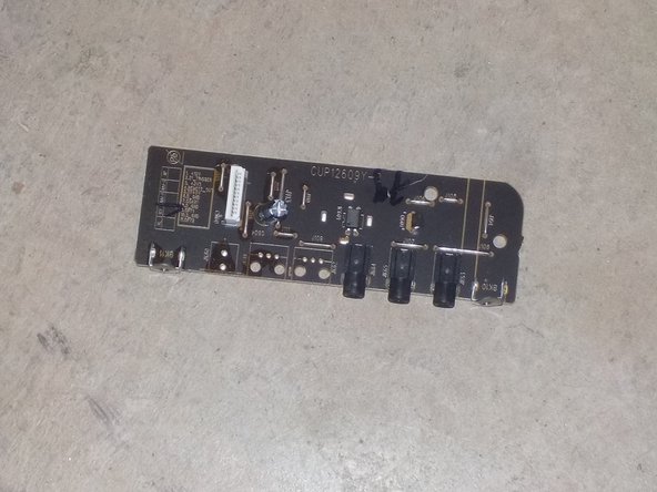

  4. Harman Kardon HK3700 Teardown, IR Board: crwdns2935265:04crwdnd2935265:01crwdnd2935265:02crwdne2935265:0 Harman Kardon HK3700 Teardown, IR Board: crwdns2935265:04crwdnd2935265:02crwdnd2935265:02crwdne2935265:0
    • At this point, you can go ahead and remove all the screws from the back panel. This will make your life easier later.
    • After the screws are removed, you can remove the IR Remote board.

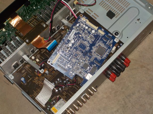

  5. Harman Kardon HK3700 Teardown, Ethernet Card: crwdns2935265:05crwdnd2935265:01crwdnd2935265:03crwdne2935265:0 Harman Kardon HK3700 Teardown, Ethernet Card: crwdns2935265:05crwdnd2935265:02crwdnd2935265:03crwdne2935265:0 Harman Kardon HK3700 Teardown, Ethernet Card: crwdns2935265:05crwdnd2935265:03crwdnd2935265:03crwdne2935265:0
    • Remove the 2 screws holding the ethernet card down to the bracket. Then, if the back panel screws are removed and all cables are disconnected, you can remove the ethernet board from the device.

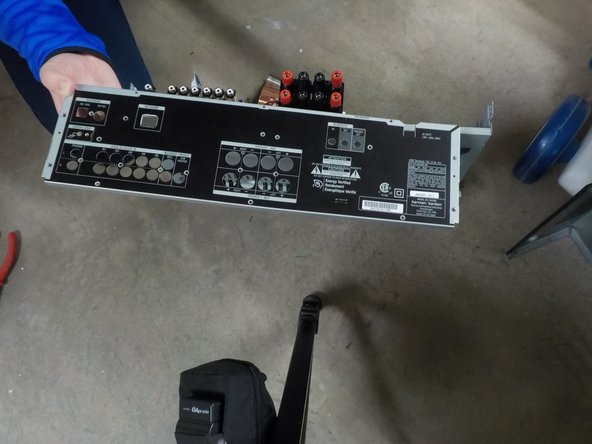

  6. Harman Kardon HK3700 Teardown, Remove the back panel: crwdns2935265:06crwdnd2935265:01crwdnd2935265:02crwdne2935265:0 Harman Kardon HK3700 Teardown, Remove the back panel: crwdns2935265:06crwdnd2935265:02crwdnd2935265:02crwdne2935265:0
    • Remove the screws holding on the back panel from both sides.
    • After the screws are removed, go ahead and remove the back panel.

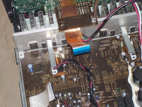

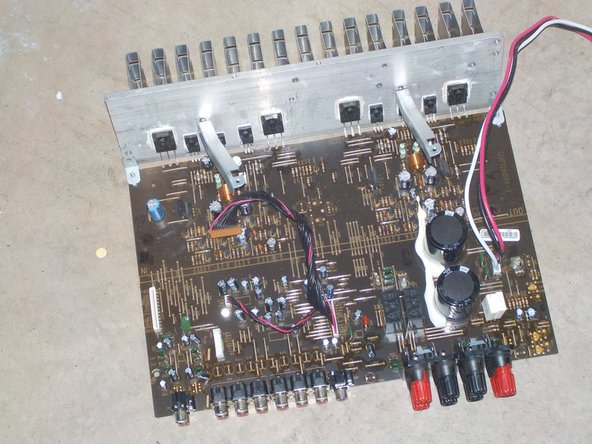

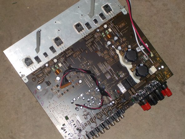

  7. Harman Kardon HK3700 Teardown, Remove the mainboard: crwdns2935265:07crwdnd2935265:01crwdnd2935265:03crwdne2935265:0 Harman Kardon HK3700 Teardown, Remove the mainboard: crwdns2935265:07crwdnd2935265:02crwdnd2935265:03crwdne2935265:0 Harman Kardon HK3700 Teardown, Remove the mainboard: crwdns2935265:07crwdnd2935265:03crwdnd2935265:03crwdne2935265:0
    • Remove all the screws holding down the main board and heat sink. Unplug the cable from the front panel if you can, or cut it if you can't. If you do cut it, it can be re-soldered later if you wish.
    • You can now remove the board from the frame.
    • I did not remove the transistors from the heat sink, but you can with a phillips screwdriver and something to separate the transistors from their thermal compound.

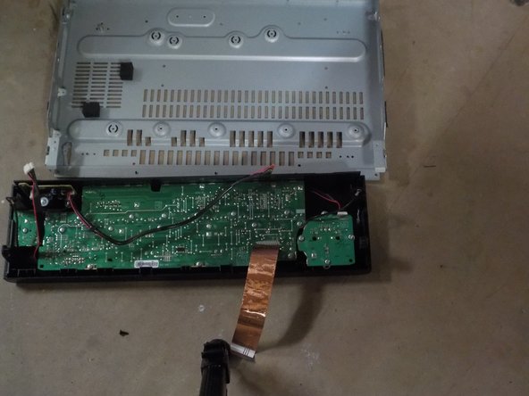

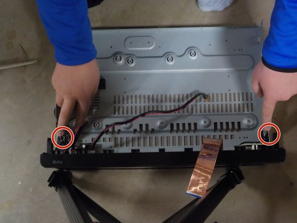

  9. Harman Kardon HK3700 Teardown, Remove the front panel: crwdns2935265:09crwdnd2935265:01crwdnd2935265:03crwdne2935265:0 Harman Kardon HK3700 Teardown, Remove the front panel: crwdns2935265:09crwdnd2935265:02crwdnd2935265:03crwdne2935265:0 Harman Kardon HK3700 Teardown, Remove the front panel: crwdns2935265:09crwdnd2935265:03crwdnd2935265:03crwdne2935265:0
    • Remove the screws from the bottom of the frame holding the front panel on.
    • Also remove the 2 larger screws from the top holding the front panel on
    • After these screws are removed, you can remove the front panel and set the frame aside.

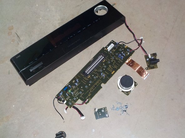

  10. Harman Kardon HK3700 Teardown, Front panel disassembly: crwdns2935265:010crwdnd2935265:01crwdnd2935265:02crwdne2935265:0 Harman Kardon HK3700 Teardown, Front panel disassembly: crwdns2935265:010crwdnd2935265:02crwdnd2935265:02crwdne2935265:0
    • Remove all the cables you can access.
    • Remove all the screws from the back of the front panel. All the pieces then lift out of the front panel.
  11. Harman Kardon HK3700 Teardown, Conclusion: crwdns2935265:011crwdnd2935265:01crwdnd2935265:02crwdne2935265:0 Harman Kardon HK3700 Teardown, Conclusion: crwdns2935265:011crwdnd2935265:02crwdnd2935265:02crwdne2935265:0
    • This is all the parts laid out. There isn't much more to say about it.
