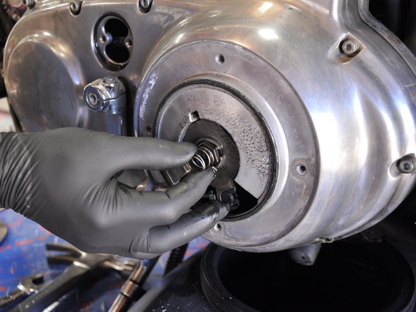

    • Using a T27 screwdriver bit, remove the four screws holding the clutch inspection cover in place.
  6. Harley-Davidson Sportster Evolution Transmission/Primary Oil Change: crwdns2935265:06crwdnd2935265:01crwdnd2935265:02crwdne2935265:0 Harley-Davidson Sportster Evolution Transmission/Primary Oil Change: crwdns2935265:06crwdnd2935265:02crwdnd2935265:02crwdne2935265:0
    Heavy-Duty Spudger
    • Insert a heavy duty spudger or similar prying tool into the gap between the clutch inspection cover and the transmission housing near where clutch cable enters the housing.
    • Gently pry the clutch inspection cover away from the transmission housing.
    • The clutch cover spring may fall out. Be sure to keep track of this and re-install it before replacing the clutch inspection cover.

I change my my transmission oil exactly how it showed and yes the spring with the nut on the end came off and I put it right back. Now I have no tension at all in my clutch basically I have no clutch anymore. This is the first time I've taken the inspection plate off during a transmission fluid change. I usually drain it and automatically just put one quart in. What could I have done wrong?
