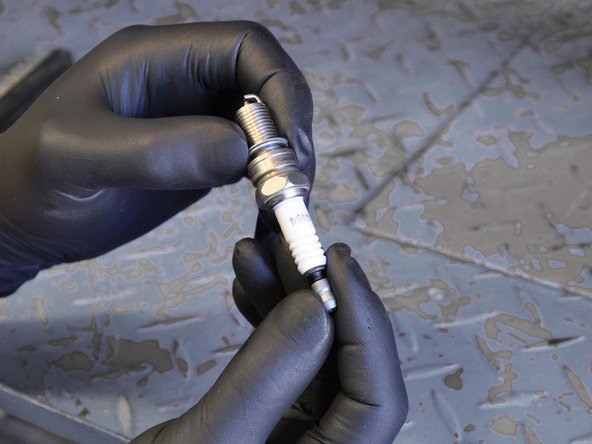

  4. Harley-Davidson Sportster Evolution Spark Plugs Replacement, Checking the new spark plug: crwdns2935265:04crwdnd2935265:01crwdnd2935265:03crwdne2935265:0 Harley-Davidson Sportster Evolution Spark Plugs Replacement, Checking the new spark plug: crwdns2935265:04crwdnd2935265:02crwdnd2935265:03crwdne2935265:0 Harley-Davidson Sportster Evolution Spark Plugs Replacement, Checking the new spark plug: crwdns2935265:04crwdnd2935265:03crwdnd2935265:03crwdne2935265:0
    • Always inspect your new spark plugs before installing. Check the gap on your replacement spark plugs with a feeler gauge. It should be set to .040 inches (1.016mm).
    • If they are not pre-installed, make sure that the crush washer and terminal nut are installed.
