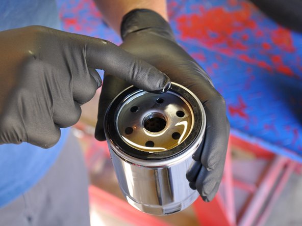

  4. Harley-Davidson Sportster Evolution Oil Change, Installing the New Oil Filter: crwdns2935265:04crwdnd2935265:01crwdnd2935265:03crwdne2935265:0 Harley-Davidson Sportster Evolution Oil Change, Installing the New Oil Filter: crwdns2935265:04crwdnd2935265:02crwdnd2935265:03crwdne2935265:0 Harley-Davidson Sportster Evolution Oil Change, Installing the New Oil Filter: crwdns2935265:04crwdnd2935265:03crwdnd2935265:03crwdne2935265:0
    • Open 1 quart of oil. Pour it into the filter until the filter is about 1/2 full.
    • Apply a small amount of clean oil to the rubber gasket on the new oil filter.
    • Wipe down the oil filter mounting area, and any oil residue that has run down onto the motorcycle.
    • Make sure that the old gasket came off with the filter, and you have a clean smooth surface to install the new filter on.
  5. Harley-Davidson Sportster Evolution Oil Change: crwdns2935265:05crwdnd2935265:01crwdnd2935265:01crwdne2935265:0
    • Carefully thread your new oil filter into place, turning it in a clockwise direction. Do not overtighten your filter. Only turn the filter a 1/2 turn past the point where you start to feel resistance from the gasket contacting the engine.

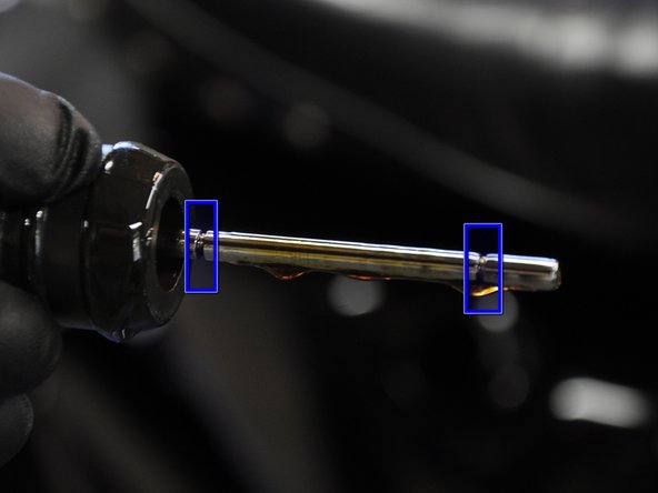

    • Pull the oil cap/dipstick off of the oil tank.
    • Some models will require the cap to be twisted first, then pulled. If you are not sure what model you have, work carefully and gently, making sure to not damage anything.
    • Using your funnel, slowly pour 3 quarts of oil into your oil tank.
    • Although the Evolution engine holds up to 3.5 quarts after a rebuild or when filled new, only 3 get replaced during the oil change.
    • Use the oilcap/dipstick to check your engine oil level (holding the bike level if you have been working with your side-stand). You oil level should be kept between the 2 dipstick marks. After refilling with 3 quarts it should be right to the top one.
It is a good idea to start your engine and let it run for a few minutes. Check your drain tube and oil filter for leaks. Recheck your oil level, and adjust if needed.
