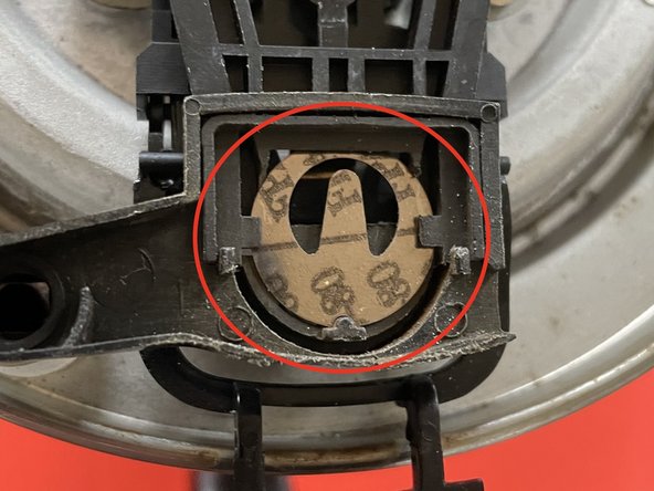

  2. Hario V60 Drip Kettle "Buono" Bimetallic strip Replacement, Base plate disassembly: crwdns2935265:02crwdnd2935265:01crwdnd2935265:01crwdne2935265:0
    • Remove the two Phillips screws (circled in red on the picture) and use a triangular bit to remove the third screw (circled in green on the picture)
  3. Hario V60 Drip Kettle "Buono" Bimetallic strip Replacement, Extracting the strip from the replacement control terminal: crwdns2935265:03crwdnd2935265:01crwdnd2935265:02crwdne2935265:0 Hario V60 Drip Kettle "Buono" Bimetallic strip Replacement, Extracting the strip from the replacement control terminal: crwdns2935265:03crwdnd2935265:02crwdnd2935265:02crwdne2935265:0
    • I couldn’t find just the bimetallic switch, so I purchased instead a replacement temperature control terminal for another type of Kettle on Amazon. The strip appeared to be pretty standard and slides right out when you lift it from the bottom notch.
  4. Hario V60 Drip Kettle "Buono" Bimetallic strip Replacement, Replacing the strip: crwdns2935265:04crwdnd2935265:01crwdnd2935265:02crwdne2935265:0 Hario V60 Drip Kettle "Buono" Bimetallic strip Replacement, Replacing the strip: crwdns2935265:04crwdnd2935265:02crwdnd2935265:02crwdne2935265:0
    • You can remove the old corroded strip from the kettle (red circle on the picture). Simply lift it from the little notch on the bottom (green circle on the picture).
    • Then you can slide in the replacement strip, with the middle metal tongue facing up. Make sure to slide it under the two plastic side guides.
    • When the water boils in the kettle, steam is sent through inner tubing down to the bimetallic strip. The strip will change shape with the heat, the tong will flip down, and trip the switch.

Extremely useful and saved us buying a new kettle. Thank you!
