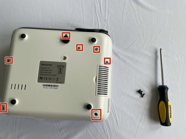

    • Flip the device upside down so that the projector's air filter is facing up.
    • Remove the filter by gently pulling it out until it pops out.

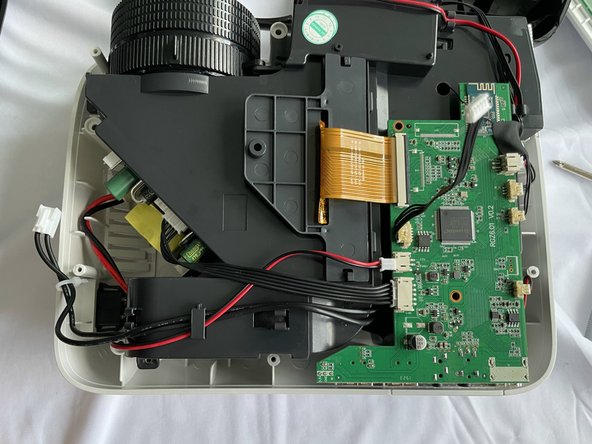

  2. Happrun H1 Cooling Fan Replacement: crwdns2935265:02crwdnd2935265:01crwdnd2935265:02crwdne2935265:0 Happrun H1 Cooling Fan Replacement: crwdns2935265:02crwdnd2935265:02crwdnd2935265:02crwdne2935265:0

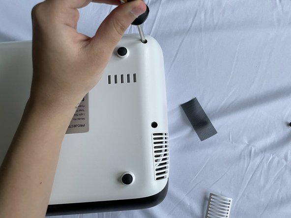

    • Use a Phillips #00 screwdriver to remove the housing screws.

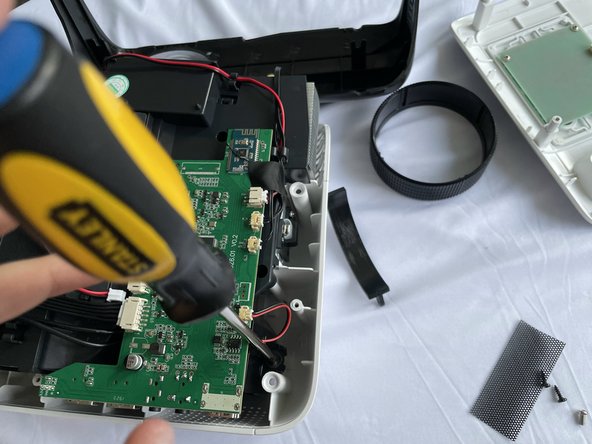

  3. Happrun H1 Cooling Fan Replacement: crwdns2935265:03crwdnd2935265:01crwdnd2935265:03crwdne2935265:0 Happrun H1 Cooling Fan Replacement: crwdns2935265:03crwdnd2935265:02crwdnd2935265:03crwdne2935265:0 Happrun H1 Cooling Fan Replacement: crwdns2935265:03crwdnd2935265:03crwdnd2935265:03crwdne2935265:0
    • After all the screws are out, insert an opening tool in the small space between the front cover and the back cover and gently lift it up.
    • Remove the covers and set aside.

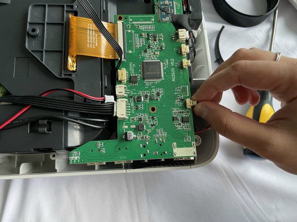

  4. Happrun H1 Cooling Fan Replacement: crwdns2935265:04crwdnd2935265:01crwdnd2935265:02crwdne2935265:0 Happrun H1 Cooling Fan Replacement: crwdns2935265:04crwdnd2935265:02crwdnd2935265:02crwdne2935265:0
    • Use your hands or an opening tool to disconnect the cables from the source.
    • To disconnect the wires, use the opening tool to lift the lock on the connector and slide the cable out of the connector.
    • Be gentle while pulling the wire to avoid signal loss.
    • These will be colorful wires connected with white plastic clips.

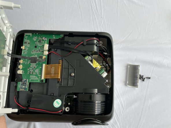

  5. Happrun H1 Cooling Fan Replacement: crwdns2935265:05crwdnd2935265:01crwdnd2935265:02crwdne2935265:0 Happrun H1 Cooling Fan Replacement: crwdns2935265:05crwdnd2935265:02crwdnd2935265:02crwdne2935265:0

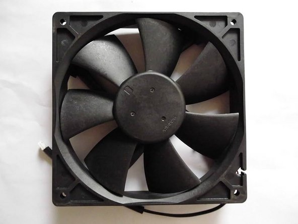

    • Gently pull out the fan from below the motherboard and swap it with a new one.

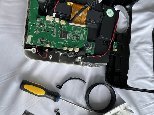

  6. Happrun H1 Cooling Fan Replacement: crwdns2935265:06crwdnd2935265:01crwdnd2935265:02crwdne2935265:0 Happrun H1 Cooling Fan Replacement: crwdns2935265:06crwdnd2935265:02crwdnd2935265:02crwdne2935265:0
    • Reconnect the wires between the fan and the motherboard.
    • Gently push the colorful cables inside the white plastic clips until it gets locked
    • Be gentle while connecting the wires.

@rudyazoulay, I jsut took apart my projector and this guide is just something weird.
There are 2 turbine type fans
DC Brushless Fan, Model: DFM7530S, DC 12V - 0.25A.
Just put it into google and you will see that one specific. I didn't find the quite one yet.
Illpet - crwdns2934203:0crwdne2934203:0
Yes this is exactly the sort of fan I´m expecting to find in there!
Gonna be tough finding a pair that lowers the fan noise tho, undervolting them could result in inadequent cooling for the LED and LCD..
If you go on ebay or google, hit "75 75 30 radial fan" and make sure to check dimensions, voltage and current, you should definitely be able to find some compatible ones.
A little tolerance on current should be fine too, I would stay away from high RPM fans as they will likely increase fan noise.
The M in DFM7530S most likely stands for Medium speed
BaguetteOmelette -

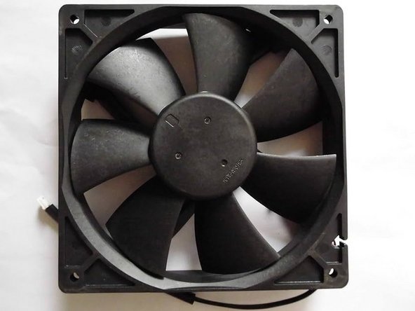

This guide is terrible, we see a picture of what is clearly a radial fan inside of the projector (Step 3) and at the beginning and end of this guide we see both a video and a picture of an axial fan (with completely the wrong dimensions for that matter).
I´ve gotten my hands on a similar projector and intend to change the fans in there real soon, I´m guessing the projector has 2 fans as the LED produces a ridiculous amount of heat.
I´ll do my best to document as much as I can and update this guide soon
