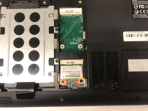

  6. Hannspree SN12E2 Wifi Card Replacement, Wifi Card: crwdns2935265:06crwdnd2935265:01crwdnd2935265:02crwdne2935265:0 Hannspree SN12E2 Wifi Card Replacement, Wifi Card: crwdns2935265:06crwdnd2935265:02crwdnd2935265:02crwdne2935265:0
    • Locate the Wifi Card in the bottom right of the hard drive access panel.
    • Remove the two antenna plugged into the the Wifi Card.
    • Remove the two 3.6mm PH0 screws.
  7. Hannspree SN12E2 Wifi Card Replacement: crwdns2935265:07crwdnd2935265:01crwdnd2935265:01crwdne2935265:0
    • Remove the Wifi Card by pulling it up and out towards yourself.
