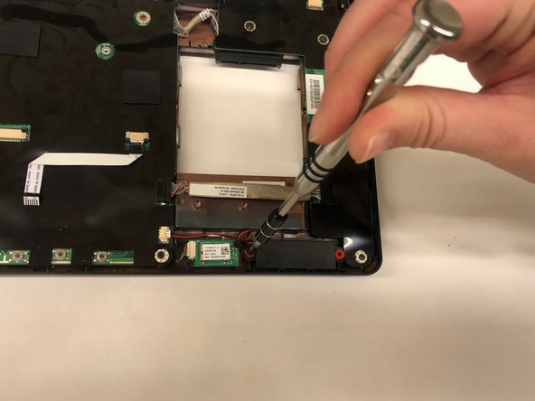

  8. Hannspree SN12E2 Speaker Replacement, Speaker: crwdns2935265:08crwdnd2935265:01crwdnd2935265:02crwdne2935265:0 Hannspree SN12E2 Speaker Replacement, Speaker: crwdns2935265:08crwdnd2935265:02crwdnd2935265:02crwdne2935265:0
    • Remove the two screws on the speakers.
  9. Hannspree SN12E2 Speaker Replacement: crwdns2935265:09crwdnd2935265:01crwdnd2935265:01crwdne2935265:0
    • Gently remove the JST connector by pulling parallel to the housing .
    • When replacing the connectors ensure that they are oriented correctly. The housing is keyed to prevent the connectors from being plugged in backwards.
  10. Hannspree SN12E2 Speaker Replacement: crwdns2935265:010crwdnd2935265:01crwdnd2935265:01crwdne2935265:0
    • Repeat same steps for other speaker if necessary.
