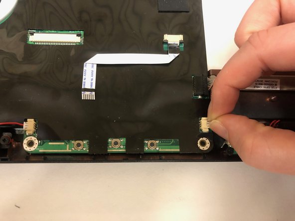

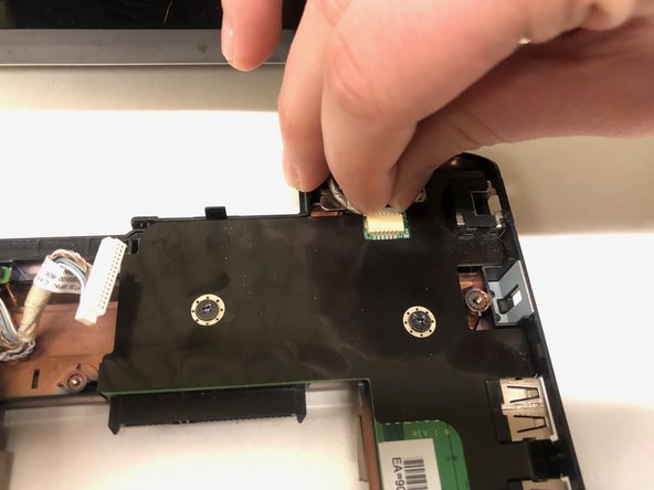

  13. Hannspree SN12E2 IO Board Replacement, IO Board: crwdns2935265:013crwdnd2935265:01crwdnd2935265:01crwdne2935265:0
    • Remove the three 3mm PH0 screws holding the IO board to the case.
  14. Hannspree SN12E2 IO Board Replacement: crwdns2935265:014crwdnd2935265:01crwdnd2935265:03crwdne2935265:0 Hannspree SN12E2 IO Board Replacement: crwdns2935265:014crwdnd2935265:02crwdnd2935265:03crwdne2935265:0 Hannspree SN12E2 IO Board Replacement: crwdns2935265:014crwdnd2935265:03crwdnd2935265:03crwdne2935265:0
    • Unplug the three JST connectors connecting the IO board to the motherboard.
    • For each connector, remove by gently pulling parallel to the connector housing until the connector becomes undone
    • When replacing the connectors ensure that they are oriented correctly. The housing is keyed to prevent the connectors from being plugged in backwards.
  15. Hannspree SN12E2 IO Board Replacement: crwdns2935265:015crwdnd2935265:01crwdnd2935265:01crwdne2935265:0
    • Remove IO Board by gently tilting it toward the outer edge of the case.
