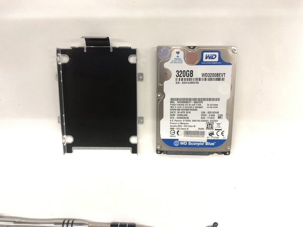

    • Next, lift up the hard drive and pull towards you. Lift up the end of the hard drive that is not plugged into the computer.
  8. Hannspree SN12E2 Hard Drive Replacement: crwdns2935265:08crwdnd2935265:01crwdnd2935265:02crwdne2935265:0 Hannspree SN12E2 Hard Drive Replacement: crwdns2935265:08crwdnd2935265:02crwdnd2935265:02crwdne2935265:0
    • Slide your hard drive out of the metal piece by unscrewing the sides.
