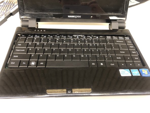

  4. Hannspree SN12E2 Fan/Motherboard Replacement, Touchpad Plane/Keyboard: crwdns2935265:04crwdnd2935265:01crwdnd2935265:01crwdne2935265:0
    • Remove all the 5mm PH0 screws on the back cover

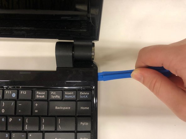

  5. Hannspree SN12E2 Fan/Motherboard Replacement: crwdns2935265:05crwdnd2935265:01crwdnd2935265:03crwdne2935265:0 Hannspree SN12E2 Fan/Motherboard Replacement: crwdns2935265:05crwdnd2935265:02crwdnd2935265:03crwdne2935265:0 Hannspree SN12E2 Fan/Motherboard Replacement: crwdns2935265:05crwdnd2935265:03crwdnd2935265:03crwdne2935265:0
    • Gently pry the case apart starting at the lower right corner using the small spudger
    • Move around the case gently prying until the touchpad plane is free from the rest of the case

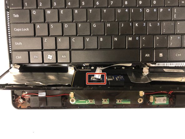

  7. Hannspree SN12E2 Fan/Motherboard Replacement: crwdns2935265:07crwdnd2935265:01crwdnd2935265:01crwdne2935265:0
    • Gently lift up on the loose keyboard to expose the ZIFF connector.
    • Unplug the keyboard ZIFF following the same instructions as the touchpad ZIFF

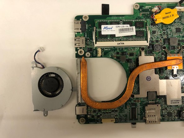

  8. Hannspree SN12E2 Fan/Motherboard Replacement, Fan/Motherboard: crwdns2935265:08crwdnd2935265:01crwdnd2935265:01crwdne2935265:0
    • Remove 3.4mm PH0 retaining screws as well as the three 3mm PH0 fan screws

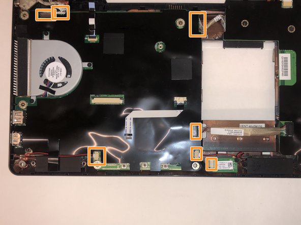

  9. Hannspree SN12E2 Fan/Motherboard Replacement: crwdns2935265:09crwdnd2935265:01crwdnd2935265:02crwdne2935265:0 Hannspree SN12E2 Fan/Motherboard Replacement: crwdns2935265:09crwdnd2935265:02crwdnd2935265:02crwdne2935265:0
    • Unplug all pictured connectors
  10. Hannspree SN12E2 Fan/Motherboard Replacement: crwdns2935265:010crwdnd2935265:01crwdnd2935265:02crwdne2935265:0 Hannspree SN12E2 Fan/Motherboard Replacement: crwdns2935265:010crwdnd2935265:02crwdnd2935265:02crwdne2935265:0
    • Remove the motherboard from the housing place it on a flat surface.
    • Flip over the motherboard so that the heat pipes ae face up.and disconnect fan JST Connector, pictured in red
