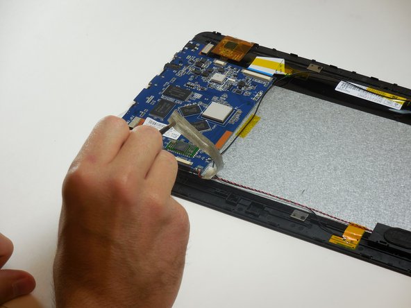

    • Use the metal spudger to press an opening between the screen and back cover.
    • The plastic tabs are located on each corner of the back cover.
    • Be careful, as the plastic tabs are delicate.
  3. Hannspree Hannspad SN1AT71 Left and Right Speaker Replacement: crwdns2935265:03crwdnd2935265:01crwdnd2935265:01crwdne2935265:0
    • Wedge the plastic opening tool between the screen and the back panel to prevent re-engagement
  4. Hannspree Hannspad SN1AT71 Left and Right Speaker Replacement: crwdns2935265:04crwdnd2935265:01crwdnd2935265:02crwdne2935265:0 Hannspree Hannspad SN1AT71 Left and Right Speaker Replacement: crwdns2935265:04crwdnd2935265:02crwdnd2935265:02crwdne2935265:0
    • Slide the metal spudger around the casing to separate it from the inside of the tablet.
  5. Hannspree Hannspad SN1AT71 Left and Right Speaker Replacement: crwdns2935265:05crwdnd2935265:01crwdnd2935265:02crwdne2935265:0 Hannspree Hannspad SN1AT71 Left and Right Speaker Replacement: crwdns2935265:05crwdnd2935265:02crwdnd2935265:02crwdne2935265:0
    • Flip the tablet over so the screen side is down after all the tabs are separated.
    • Remove the back panel by delicately lifting it straight up.

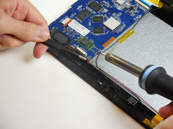

    • Instructions for desoldering can be found on the iFixit website.
    • The soldering iron is hot. It can burn you and it can cause damage to the wires and motherboard.
    • Grab hold of the red wire using the tweezers.
    • Desolder the red wire connection from the motherboard using the tip of the soldering iron.
    • Move the wire connection away from the motherboard.
    • Do not let the red wire connection touch other wires or the motherboard.

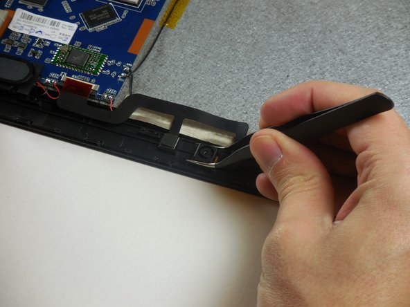

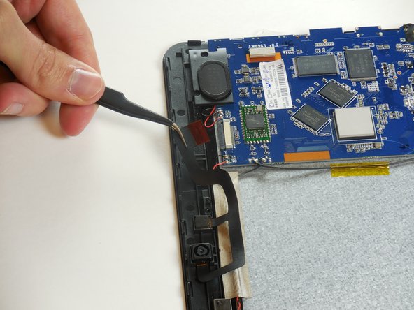

  10. Hannspree Hannspad SN1AT71 Left and Right Speaker Replacement, Front and Rear Camera Replacement: crwdns2935265:010crwdnd2935265:01crwdnd2935265:02crwdne2935265:0 Hannspree Hannspad SN1AT71 Left and Right Speaker Replacement, Front and Rear Camera Replacement: crwdns2935265:010crwdnd2935265:02crwdnd2935265:02crwdne2935265:0

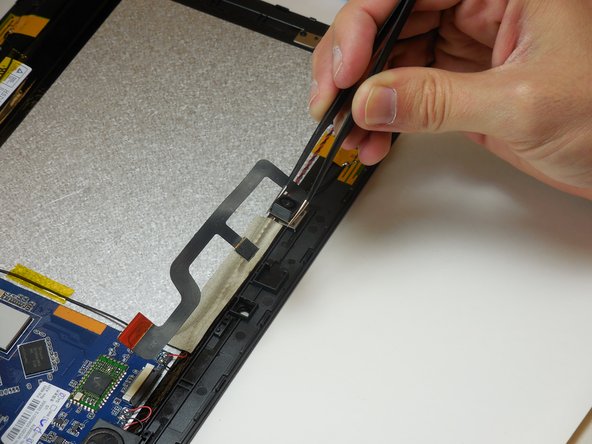

    • Identify the ribbon connecter attached to the camera and where it connects to the circuit board.
    • The two cameras are connected with one ribbon cable.
    • Zero insertion force connector.

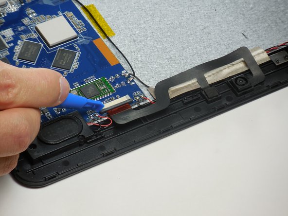

  11. Hannspree Hannspad SN1AT71 Left and Right Speaker Replacement: crwdns2935265:011crwdnd2935265:01crwdnd2935265:03crwdne2935265:0 Hannspree Hannspad SN1AT71 Left and Right Speaker Replacement: crwdns2935265:011crwdnd2935265:02crwdnd2935265:03crwdne2935265:0 Hannspree Hannspad SN1AT71 Left and Right Speaker Replacement: crwdns2935265:011crwdnd2935265:03crwdnd2935265:03crwdne2935265:0
    • Disconnect the sliding zero insertion force (ZIF). Use the plastic opening tool or a fingernail to slide the tab out, then pull the cable out.
  12. Hannspree Hannspad SN1AT71 Left and Right Speaker Replacement: crwdns2935265:012crwdnd2935265:01crwdnd2935265:03crwdne2935265:0 Hannspree Hannspad SN1AT71 Left and Right Speaker Replacement: crwdns2935265:012crwdnd2935265:02crwdnd2935265:03crwdne2935265:0 Hannspree Hannspad SN1AT71 Left and Right Speaker Replacement: crwdns2935265:012crwdnd2935265:03crwdnd2935265:03crwdne2935265:0
    • Pull the cameras out of their resting places in a straight upward motion.

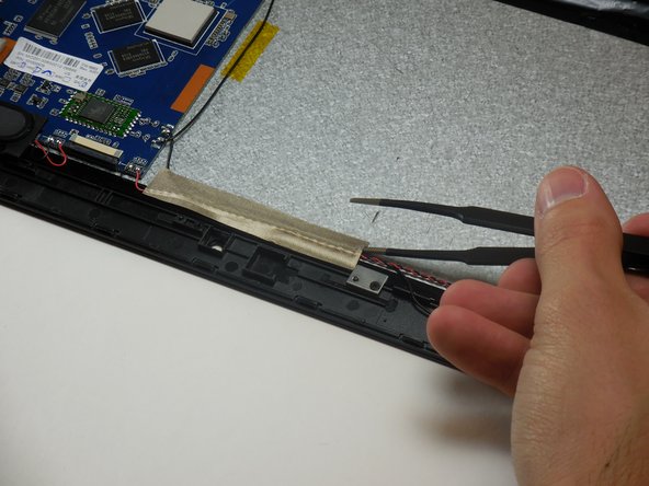

  13. Hannspree Hannspad SN1AT71 Left and Right Speaker Replacement, Left and Right Speaker: crwdns2935265:013crwdnd2935265:01crwdnd2935265:03crwdne2935265:0 Hannspree Hannspad SN1AT71 Left and Right Speaker Replacement, Left and Right Speaker: crwdns2935265:013crwdnd2935265:02crwdnd2935265:03crwdne2935265:0 Hannspree Hannspad SN1AT71 Left and Right Speaker Replacement, Left and Right Speaker: crwdns2935265:013crwdnd2935265:03crwdnd2935265:03crwdne2935265:0

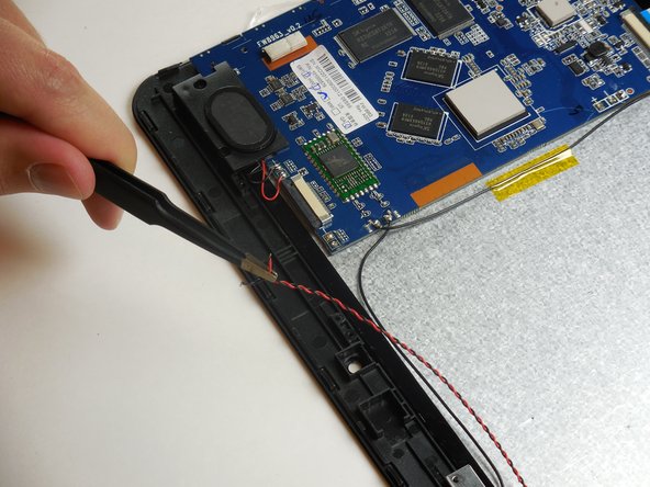

    • Identify the speakers.
    • Use a pair of tweezers to peel the adhesive tape holding the speaker wires down.
  14. Hannspree Hannspad SN1AT71 Left and Right Speaker Replacement: crwdns2935265:014crwdnd2935265:01crwdnd2935265:03crwdne2935265:0 Hannspree Hannspad SN1AT71 Left and Right Speaker Replacement: crwdns2935265:014crwdnd2935265:02crwdnd2935265:03crwdne2935265:0 Hannspree Hannspad SN1AT71 Left and Right Speaker Replacement: crwdns2935265:014crwdnd2935265:03crwdnd2935265:03crwdne2935265:0

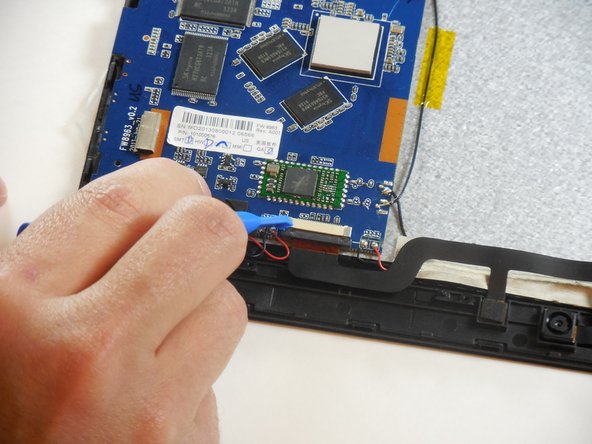

    • Desolder the red and black wire to the left and the right of the ZIF connector.
    • Remember the placement of both wires.
    • Both the soldering iron and the wires will be hot.

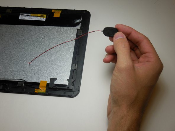

  15. Hannspree Hannspad SN1AT71 Left and Right Speaker Replacement: crwdns2935265:015crwdnd2935265:01crwdnd2935265:02crwdne2935265:0 Hannspree Hannspad SN1AT71 Left and Right Speaker Replacement: crwdns2935265:015crwdnd2935265:02crwdnd2935265:02crwdne2935265:0
    • Remove the right and left speaker.
