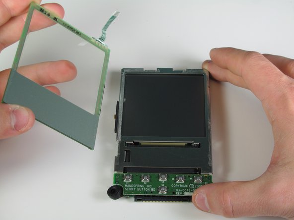

  7. Handspring Visor Edge Screen Replacement, Screen: crwdns2935265:07crwdnd2935265:01crwdnd2935265:01crwdne2935265:0
    • Place the PDA front face up.
    • Gently pull off the front cover.

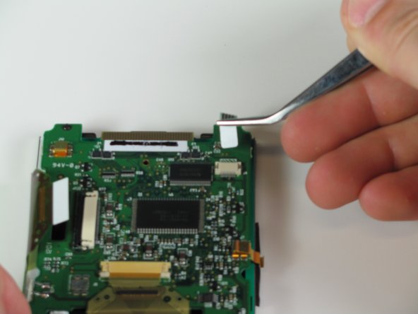

    • Flip over the PDA.
    • Use the tweezers to remove the ribbon cable attaching the screen to the circuit board.
  9. Handspring Visor Edge Screen Replacement: crwdns2935265:09crwdnd2935265:01crwdnd2935265:02crwdne2935265:0 Handspring Visor Edge Screen Replacement: crwdns2935265:09crwdnd2935265:02crwdnd2935265:02crwdne2935265:0
    • Wedge the spudger in between the glass and the metal frame.
    • Slide the spudger down the length of the screen to detach from the frame.
    • With your hands, pry the screen up from the detached side. The screen will pop off.
