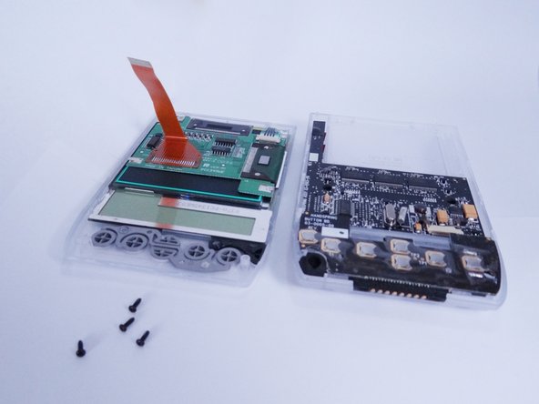

  6. Handspring Visor Deluxe PDA Touch Screen Replacement, Back Cover: crwdns2935265:06crwdnd2935265:01crwdnd2935265:01crwdne2935265:0
    • Unscrew the four 2.94mm screws with a #00 Phillips screwdriver.
    • One end of the OEM stylus can unscrew and contains a mini #00 Phillips screwdriver.

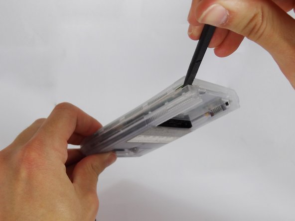

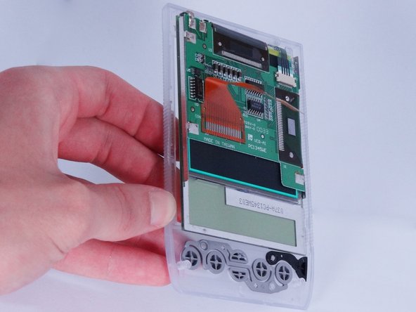

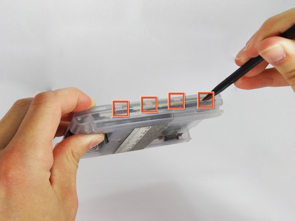

  7. Handspring Visor Deluxe PDA Touch Screen Replacement: crwdns2935265:07crwdnd2935265:01crwdnd2935265:03crwdne2935265:0 Handspring Visor Deluxe PDA Touch Screen Replacement: crwdns2935265:07crwdnd2935265:02crwdnd2935265:03crwdne2935265:0 Handspring Visor Deluxe PDA Touch Screen Replacement: crwdns2935265:07crwdnd2935265:03crwdnd2935265:03crwdne2935265:0
    • Use the spudger to pry open the casing by applying pressure at 4 clips on both sides of the device.
    • Be careful while opening the casing as there is a flex strip connecting the two halves.

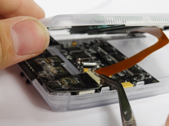

  8. Handspring Visor Deluxe PDA Touch Screen Replacement: crwdns2935265:08crwdnd2935265:01crwdnd2935265:03crwdne2935265:0 Handspring Visor Deluxe PDA Touch Screen Replacement: crwdns2935265:08crwdnd2935265:02crwdnd2935265:03crwdne2935265:0 Handspring Visor Deluxe PDA Touch Screen Replacement: crwdns2935265:08crwdnd2935265:03crwdnd2935265:03crwdne2935265:0
    • Disconnect the flex strip from the motherboard with tweezers.

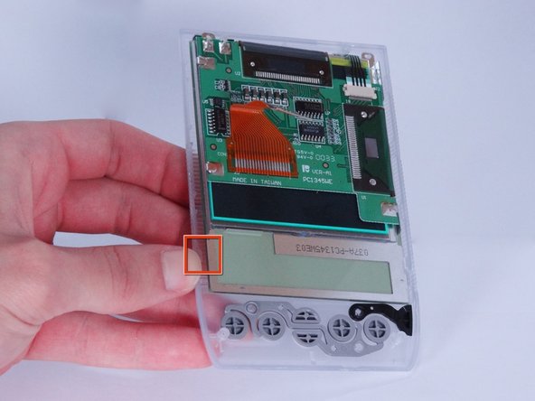

  9. Handspring Visor Deluxe PDA Touch Screen Replacement, Touch Screen: crwdns2935265:09crwdnd2935265:01crwdnd2935265:03crwdne2935265:0 Handspring Visor Deluxe PDA Touch Screen Replacement, Touch Screen: crwdns2935265:09crwdnd2935265:02crwdnd2935265:03crwdne2935265:0 Handspring Visor Deluxe PDA Touch Screen Replacement, Touch Screen: crwdns2935265:09crwdnd2935265:03crwdnd2935265:03crwdne2935265:0
    • Release the latch in bottom right corner of the touchscreen.
    • Use the spudger (if needed) to pry the screen from the front case.
