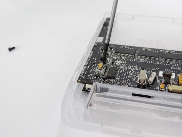

  11. Handspring Visor Deluxe PDA Motherboard and Memory card I/O Replacement, Motherboard and Memory card I/O: crwdns2935265:011crwdnd2935265:01crwdnd2935265:02crwdne2935265:0 Handspring Visor Deluxe PDA Motherboard and Memory card I/O Replacement, Motherboard and Memory card I/O: crwdns2935265:011crwdnd2935265:02crwdnd2935265:02crwdne2935265:0
    • Unscrew the two 2.94mm Phillips #00 screws that hold the motherboard in place.

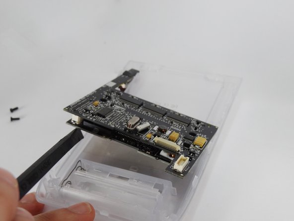

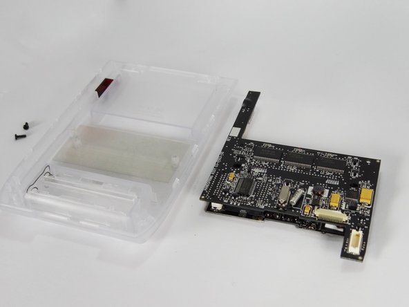

  12. Handspring Visor Deluxe PDA Motherboard and Memory card I/O Replacement: crwdns2935265:012crwdnd2935265:01crwdnd2935265:03crwdne2935265:0 Handspring Visor Deluxe PDA Motherboard and Memory card I/O Replacement: crwdns2935265:012crwdnd2935265:02crwdnd2935265:03crwdne2935265:0 Handspring Visor Deluxe PDA Motherboard and Memory card I/O Replacement: crwdns2935265:012crwdnd2935265:03crwdnd2935265:03crwdne2935265:0
    • Use the spudger to lift the motherboard from the case.
