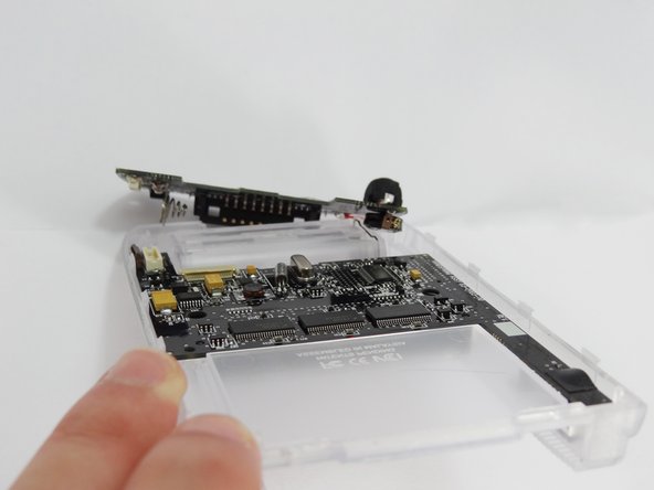

  8. Handspring Visor Deluxe PDA Button Pad and Battery Terminal Replacement: crwdns2935265:08crwdnd2935265:01crwdnd2935265:03crwdne2935265:0 Handspring Visor Deluxe PDA Button Pad and Battery Terminal Replacement: crwdns2935265:08crwdnd2935265:02crwdnd2935265:03crwdne2935265:0 Handspring Visor Deluxe PDA Button Pad and Battery Terminal Replacement: crwdns2935265:08crwdnd2935265:03crwdnd2935265:03crwdne2935265:0
    • Disconnect the flex strip from the motherboard with tweezers.

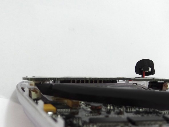

  10. Handspring Visor Deluxe PDA Button Pad and Battery Terminal Replacement: crwdns2935265:010crwdnd2935265:01crwdnd2935265:03crwdne2935265:0 Handspring Visor Deluxe PDA Button Pad and Battery Terminal Replacement: crwdns2935265:010crwdnd2935265:02crwdnd2935265:03crwdne2935265:0 Handspring Visor Deluxe PDA Button Pad and Battery Terminal Replacement: crwdns2935265:010crwdnd2935265:03crwdnd2935265:03crwdne2935265:0
    • Disconnect the button pad by using the spudger to pry it off the motherboard.
    • Remove the button pad.
