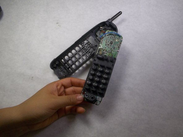

  3. Handset Microphone Replacement: crwdns2935265:03crwdnd2935265:01crwdnd2935265:02crwdne2935265:0 Handset Microphone Replacement: crwdns2935265:03crwdnd2935265:02crwdnd2935265:02crwdne2935265:0
    • After removing the back cover, you will see 3 screws: one 7mm Phillips #0 screw at the top and two 11mm Phillips #0 screws at the bottom.
    • Use a screwdriver to remove all 3 screws.

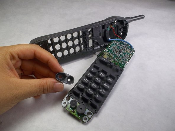

  4. Handset Microphone Replacement, Handset Microphone: crwdns2935265:04crwdnd2935265:01crwdnd2935265:02crwdne2935265:0 Handset Microphone Replacement, Handset Microphone: crwdns2935265:04crwdnd2935265:02crwdnd2935265:02crwdne2935265:0
    • After disassembling the handset, you will see the inner components of the handset.
    • Locate the rubber part towards the very bottom of the handset. This is the microphone with protective rubber cover.
    • Remove the protective rubber cover. This may require a spudger.
    • The microphone is exposed upon removal of the protective rubber cover. Avoid contact with water.
