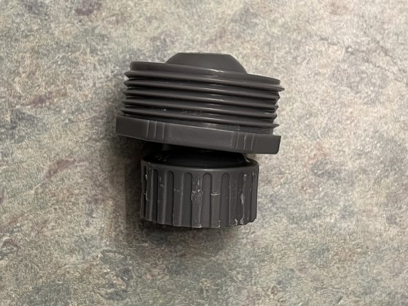

  2. Handheld Shower Head Replacement: crwdns2935265:02crwdnd2935265:01crwdnd2935265:01crwdne2935265:0
    • Unscrew the nut attached to the shower head connected to the wall using a wrench.
  3. Handheld Shower Head Replacement: crwdns2935265:03crwdnd2935265:01crwdnd2935265:03crwdne2935265:0 Handheld Shower Head Replacement: crwdns2935265:03crwdnd2935265:02crwdnd2935265:03crwdne2935265:0 Handheld Shower Head Replacement: crwdns2935265:03crwdnd2935265:03crwdnd2935265:03crwdne2935265:0
