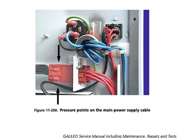

  4. Hamilton Galileo Ventilator Power Supply Replacement, Power Supply: crwdns2935265:06crwdnd2935265:01crwdnd2935265:02crwdne2935265:0 Hamilton Galileo Ventilator Power Supply Replacement, Power Supply: crwdns2935265:06crwdnd2935265:02crwdnd2935265:02crwdne2935265:0
    • Remove all cables connecting power supply to GALILEO.
    • To remove the main power connector, squeeze on the two points indicated in the second picture.
    • Remove the rear cover and place it on a suitable surface.
