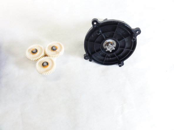

    • Lift and remove the plastic gears at the center of the device.
    • Remove any grease residue underneath the plastic gears.

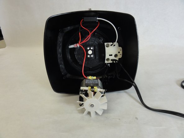

  9. Hamilton Beach Food Processor 70740 Motor/Cord Replacement: crwdns2935265:09crwdnd2935265:01crwdnd2935265:02crwdne2935265:0 Hamilton Beach Food Processor 70740 Motor/Cord Replacement: crwdns2935265:09crwdnd2935265:02crwdnd2935265:02crwdne2935265:0
    • Remove the remaining screws to unhinge the motor located at the center of the device using a screw driver.
