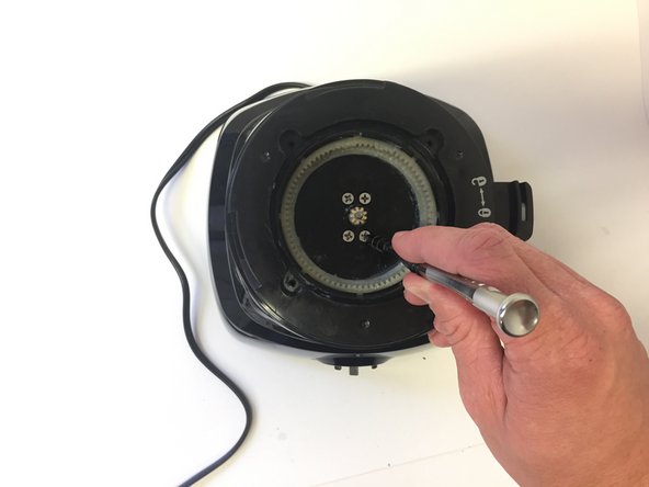

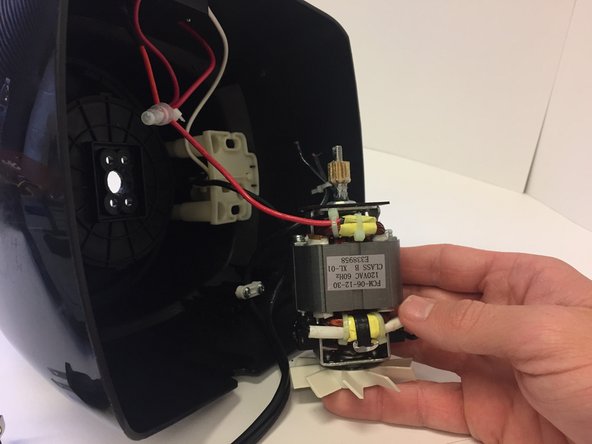

  4. Hamilton Beach 70740 Power Cord Replacement, Power Cord: crwdns2935265:04crwdnd2935265:01crwdnd2935265:03crwdne2935265:0 Hamilton Beach 70740 Power Cord Replacement, Power Cord: crwdns2935265:04crwdnd2935265:02crwdnd2935265:03crwdne2935265:0 Hamilton Beach 70740 Power Cord Replacement, Power Cord: crwdns2935265:04crwdnd2935265:03crwdnd2935265:03crwdne2935265:0
    • Using a #2 Phillips head screwdriver, remove the four 9 mm screws.
    • From the open base pull the motor straight out.
  5. Hamilton Beach 70740 Power Cord Replacement: crwdns2935265:05crwdnd2935265:01crwdnd2935265:01crwdne2935265:0
    • Using the wire stripper crimping tool cut the black wire connection from the power cord to the motor and then rewire the new power cord to the motor.

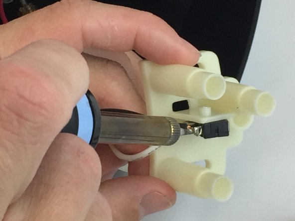

  8. Hamilton Beach 70740 Power Cord Replacement: crwdns2935265:08crwdnd2935265:01crwdnd2935265:02crwdne2935265:0 Hamilton Beach 70740 Power Cord Replacement: crwdns2935265:08crwdnd2935265:02crwdnd2935265:02crwdne2935265:0
    • Remove the power cord from the ground by removing the solder with the soldering tool.
    • Solder the new ground from the new power cord.
