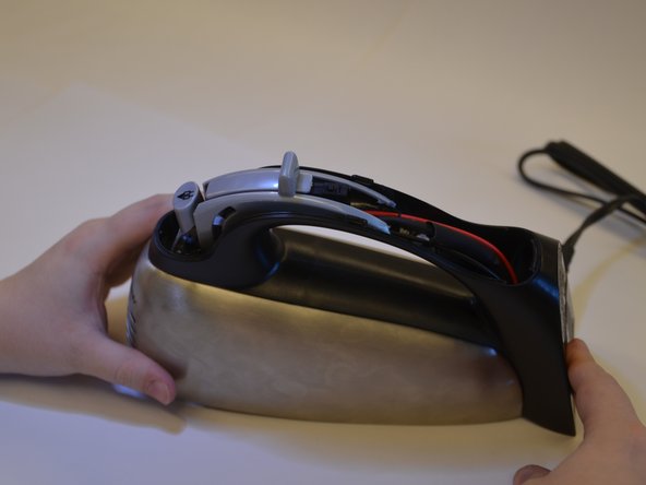

    • Flip the handle on its side. Remove five 3.8 mm Philips #2 screws shown and set aside them aside.

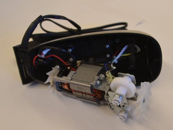

    • Remove the four 8.6 mm Philips #2 screws securing the motor mount and place them aside.
  3. Hamilton Beach 64650 Speed Level Replacement: crwdns2935265:03crwdnd2935265:01crwdnd2935265:03crwdne2935265:0 Hamilton Beach 64650 Speed Level Replacement: crwdns2935265:03crwdnd2935265:02crwdnd2935265:03crwdne2935265:0 Hamilton Beach 64650 Speed Level Replacement: crwdns2935265:03crwdnd2935265:03crwdnd2935265:03crwdne2935265:0

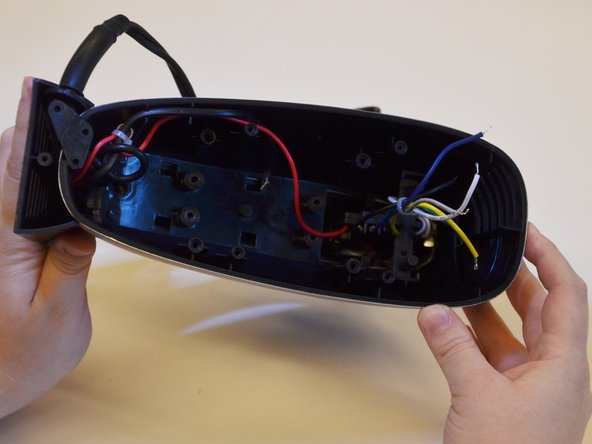

    • Carefully pull the motor block out of the case.
    • Collect the two spring located on top of the white beater gears. The springs are held in place with compression, and may fall into the case when the motor is moved.
    • Handle the wires with care to ensure you do not break any of them.

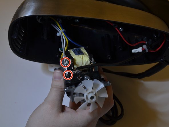

    • Desolder the six wires connected to the motor using this guide.
    • Make sure to note colors when you disconnect them and remember where to reconnect them later.
  5. Hamilton Beach 64650 Speed Level Replacement: crwdns2935265:05crwdnd2935265:01crwdnd2935265:02crwdne2935265:0 Hamilton Beach 64650 Speed Level Replacement: crwdns2935265:05crwdnd2935265:02crwdnd2935265:02crwdne2935265:0
    • Once disconnected, the motor will slide out easily.

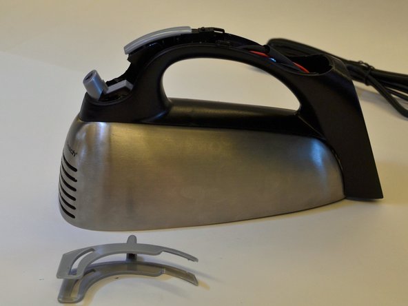

    • Remove the seven 5.6 mm Philips #2 screws that attach the motor casing to the mixer handle and set them aside.
  7. Hamilton Beach 64650 Speed Level Replacement: crwdns2935265:07crwdnd2935265:01crwdnd2935265:03crwdne2935265:0 Hamilton Beach 64650 Speed Level Replacement: crwdns2935265:07crwdnd2935265:02crwdnd2935265:03crwdne2935265:0 Hamilton Beach 64650 Speed Level Replacement: crwdns2935265:07crwdnd2935265:03crwdnd2935265:03crwdne2935265:0
    • Use a plastic opening tool to take off the handle's cap by loosening both ends and then sliding the tool to the middle of the handle.
  8. Hamilton Beach 64650 Speed Level Replacement: crwdns2935265:08crwdnd2935265:01crwdnd2935265:02crwdne2935265:0 Hamilton Beach 64650 Speed Level Replacement: crwdns2935265:08crwdnd2935265:02crwdnd2935265:02crwdne2935265:0
    • Remove the handle's cap carefully.
    • Watch out for the quick burst button, it likes to run away.

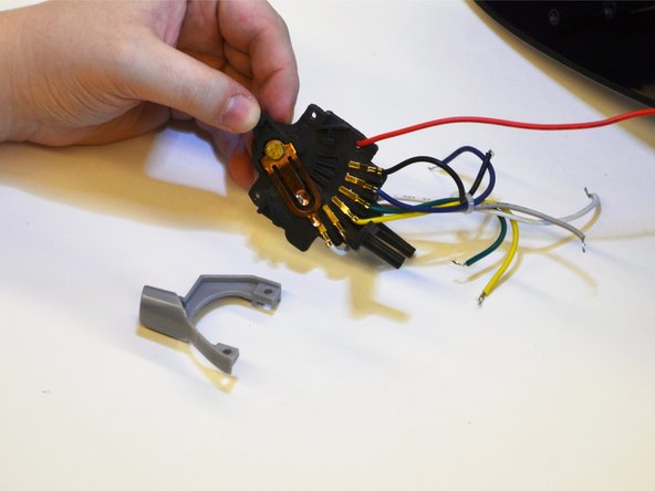

    • Slide the speed switch forward and lift upward off of the handle.
  10. Hamilton Beach 64650 Speed Level Replacement: crwdns2935265:010crwdnd2935265:01crwdnd2935265:02crwdne2935265:0 Hamilton Beach 64650 Speed Level Replacement: crwdns2935265:010crwdnd2935265:02crwdnd2935265:02crwdne2935265:0
    • Remove speed level from the inside of the case by applying light pressure toward you.
    • Do not pull on the wires to remove the speed level.
  11. Hamilton Beach 64650 Speed Level Replacement: crwdns2935265:011crwdnd2935265:01crwdnd2935265:03crwdne2935265:0 Hamilton Beach 64650 Speed Level Replacement: crwdns2935265:011crwdnd2935265:02crwdnd2935265:03crwdne2935265:0 Hamilton Beach 64650 Speed Level Replacement: crwdns2935265:011crwdnd2935265:03crwdnd2935265:03crwdne2935265:0
    • Remove the beater release button from speed level by removing the two 1.3 mm Philips #2 screws.
    • Replace the speed level assembly.
