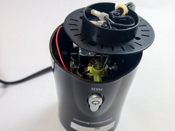

      • Unhinge the motor platform from the blender.
      • You may need a plastic spudger to unhinge the plastic bottom piece from the base of the blender.
      • You do not need to completely remove this piece from the base.
    5. Hamilton Beach 51101BA Power Button Replacement: crwdns2935265:05crwdnd2935265:01crwdnd2935265:01crwdne2935265:0
      • Pull out the rectangular green piece.
      • This is the actual power button.
    6. Hamilton Beach 51101BA Power Button Replacement: crwdns2935265:06crwdnd2935265:01crwdnd2935265:01crwdne2935265:0
      • Some experience in soldering is required!
      • On the back of the power button, desolder the red and grey wires that are connected to the piece.
