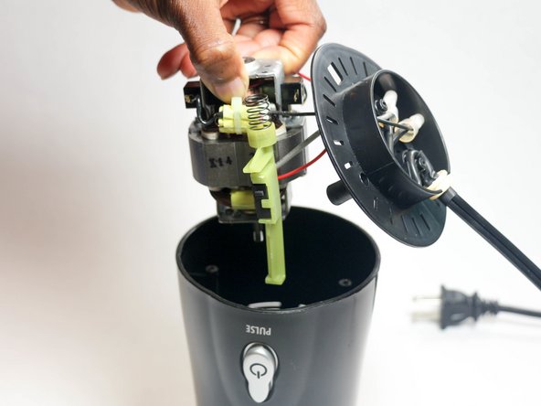

    1. Hamilton Beach 51101BA Motor Replacement, Motor: crwdns2935265:07crwdnd2935265:01crwdnd2935265:02crwdne2935265:0 Hamilton Beach 51101BA Motor Replacement, Motor: crwdns2935265:07crwdnd2935265:02crwdnd2935265:02crwdne2935265:0
      • Move the motor platform to the side.
      • Lift up the motor and remove it from the blender.
    2. Hamilton Beach 51101BA Motor Replacement: crwdns2935265:08crwdnd2935265:01crwdnd2935265:01crwdne2935265:0
      • Some soldering experience required!
      • Desolder the red wire from the green plastic piece.
    3. Hamilton Beach 51101BA Motor Replacement: crwdns2935265:09crwdnd2935265:01crwdnd2935265:01crwdne2935265:0
      • Cut the thin black wire from the wire cap.

This article appears to be unfinished. You cut 2 wires at the end... then what? Reconnecting them doesn't make any sense.
